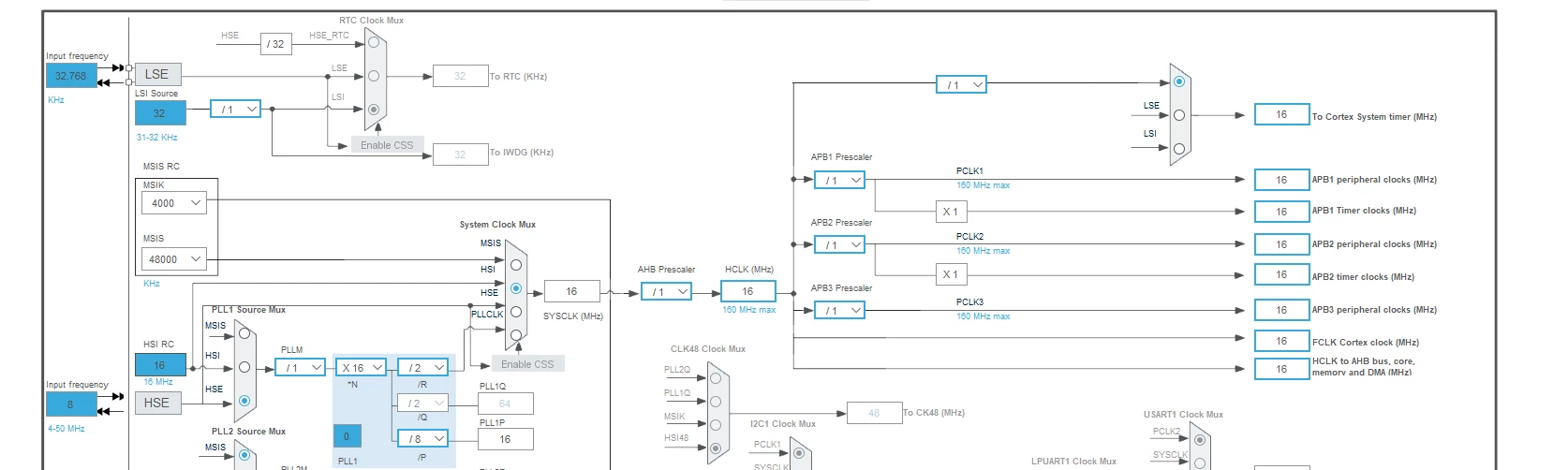

I'm working on setting up a brand new Nucleo STM32U5A5Z development board and have some issues.
My project is a completely bare-bones default with no security or BSP enabled. The application fails in SystemClock_Config() and enters the error handler. The issue seems to be related to the HSE as SystemClock_Config returns HAL_TIMEOUT here:
 /* Check the HSE State */
 if (pRCC_OscInitStruct->HSEState != RCC_HSE_OFF)
 tickstart = HAL_GetTick();
 /* Wait till HSE is ready */
 while (READ_BIT(RCC->CR, RCC_CR_HSERDY) == 0U)
 if ((HAL_GetTick() - tickstart) > HSE_TIMEOUT_VALUE)
 return HAL_TIMEOUT;

Thank you for the sharing.
It seems to be an issue with that default config.
Please try the configuration I shared previously. According to the board's schematic, HSE is not using Bypass mode (For STLINK MCO output) but a crystal of 16MHz:
As you can see in the schematic, STLINK-MCO is disconnected by default and the default configuration is a Crystal of 16MHz.
If you confirm that, I will raise a ticket to fix that in CubeMx.
Hope that helps.

2- What clock source frequency value you set to HSE? 16MHz in HSE crystal mode?:

Here is a snippet of the default clock config:
- System clock is set to 16 MHz
- HSE at 8 MHz is used as clock source.
- HSE enabled as "BYPASS Clock Source"
Aren't these settings weird as a default for the Nucleo board? I would expect 160 MHz as the sysclk. Also, changing HSE to "Crystal/Ceramic Resonator" seems to fix the error in SystemClock_Config().
Hope that helps.
