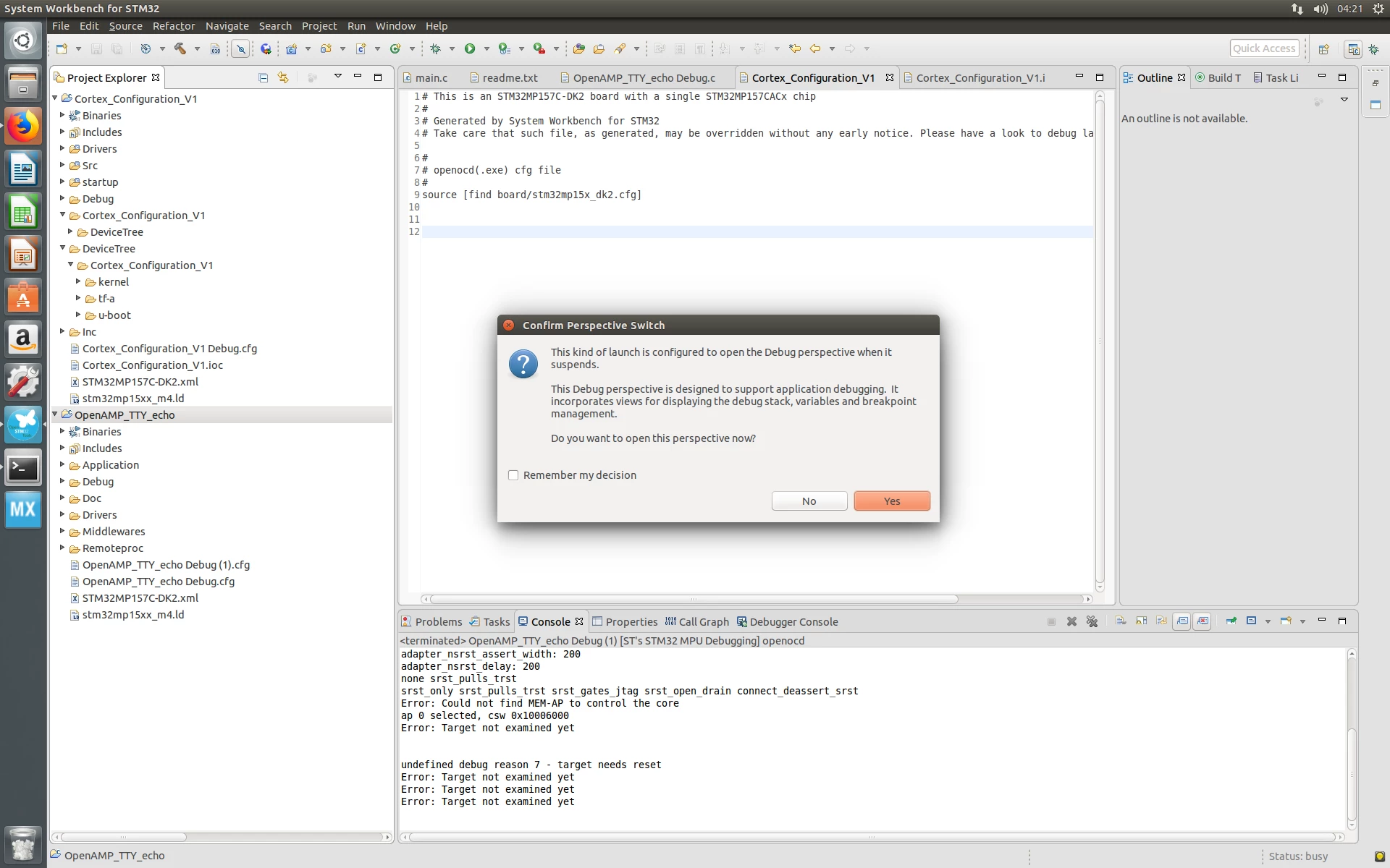

Hallo ,
I am trying to debug an imported project from CubeMx, which is just the configuration of the STM32MP!57C-DK2 board, I built the solution in the system workbench and then connected to the board. on the Console I cannot see any IP Address for the board, so i used ifconfig, and i entered the eth0 ip address in the debug configuration, when i debug the solution, i end up with this error message(attached).
I attached my debug configuration as well. I also tried port 3333 which got the same problem
I tried to debug just the OPENAMP_TTY example, it cannot be compiled (Photo- OpenAMP)
I wonder what is wrong?. Your help is very much appreciated
Note; Regarding the OpenAMP problem, I saw the answered question, i followed the answer but the problem still exists. Maybe there should be some sort of special ocd or gdb config?. I am not sure as am totally new to that board
Thanks in Advance

Since latest release last week, STM32CubeIDE (v1.1.0) is now supporting STM32MP1 products. You could regenerate your project using latest STM32CubeMX v5.4
for STM32CubeIDE and work after that directly in STMCubeIDE for both project configuration and compilation.
Would it be possible to give it a try ?
HHass.1102
Oct 25, 2019 3:55 PM UTC
Hello.
Thansk alot for answering, I downloaded and Install the IDE, the project is successfully converted from system workbench to cube IDE format, I built it without problems, but it seems to be a network configuration problem, since the IP Address is not reachable. Do i have to have a second netwrok driver in my PC to connect the board directly to it and then see what ip address it gets, now i have a switch between my pc and the board.
does the board have to have an ip of 10.192.x.x?
Thanks in Advance
