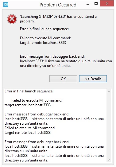

I have a NUCLEO F103RB board with STM32F103RB MCU. I am doing my first program for blinking a LED (I am starting with STM32 MCU family).
I use STM32CubeIDE just downloaded in the last days.
I compile my simple program without problems.
The debug phase does not happen due to the following error I read on the console:
this is the message
Open On-Chip Debugger 0.10.0+dev-01193-g5ce997d (2020-02-20-10:57)
Licensed under GNU GPL v2
For bug reports, read
http://openocd.org/doc/doxygen/bugs.html
none separate
Info : The selected transport took over low-level target control. The results might differ compared to plain JTAG/SWD
adapter speed: 8000 kHz
adapter_nsrst_delay: 100
Info : Listening on port 6666 for tcl connections
Info : Listening on port 4444 for telnet connections
Info : clock speed 8000 kHz
Info : STLINK V2J36S26 (API v2) VID:PID 0483:374B
Info : using stlink api v2
Info : Target voltage: 3.239448
Error: init mode failed (unable to connect to the target)
Moreover an additional window (titled PROBLEM OCCURED appears)
with an additional message: I attach the window picture in the annex.
I hope you could help me. I do not understand where is the problem.
My working configuration is
Nucleo board connected to the USB port, where I read the file details.txt
with the following test
Version: 0221
Build:  Dec 20 2019 11:22:25
Debug configuration
Autostart local GDB server
Debug probe: ST-LINK(OpenOCD)
Reset mode: Software System Reset
I hope you can support me.
