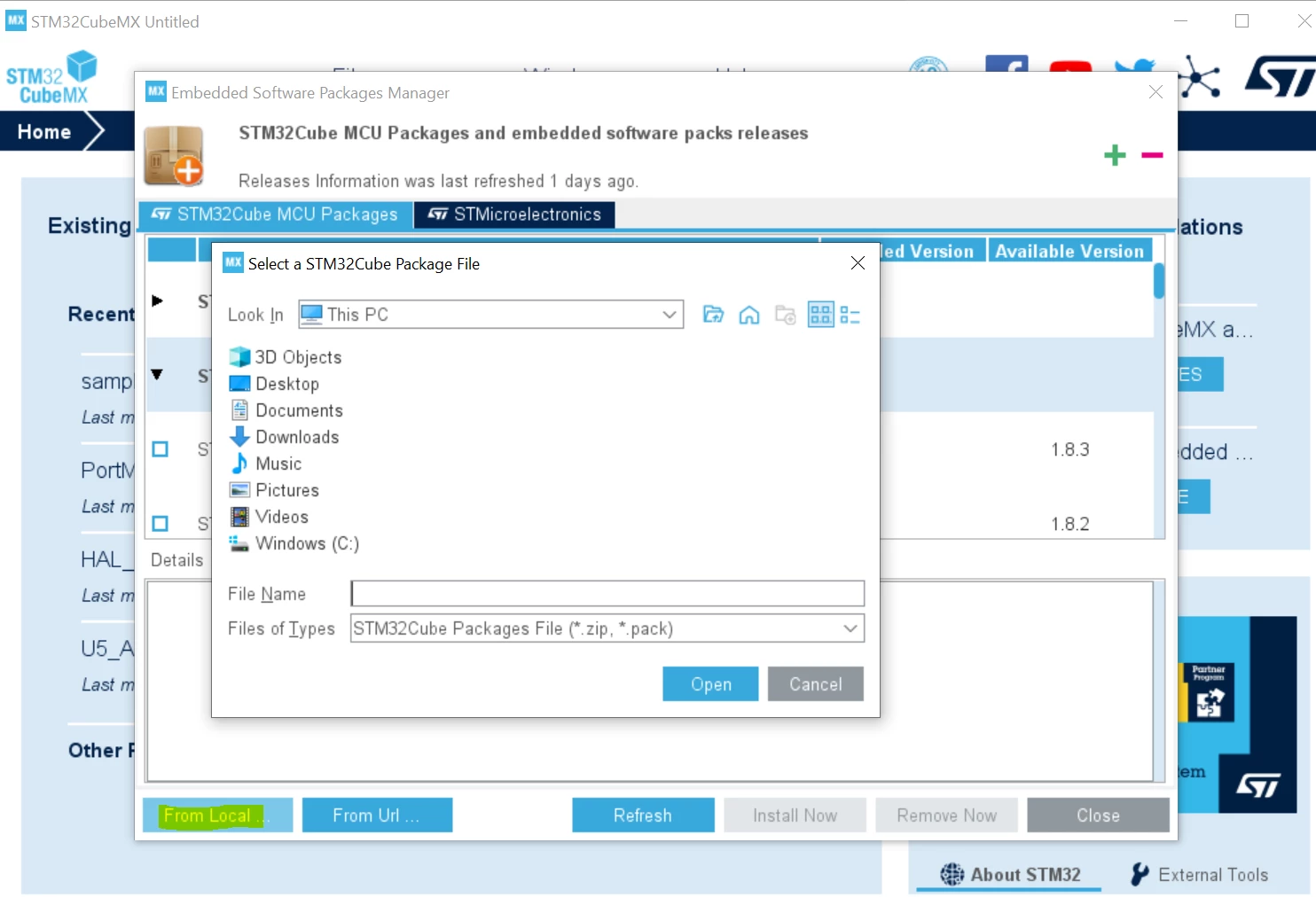

Khouloud OTHMAN
February 18, 2021
Hello @APlot.1​
Welcome to the STM32 Community :)
If I well understand your question, you have downloaded the STM32Cube MCU Package for STM32F1 and you want to complete the installation in STM32CubeMX.
In this case you can  select Help > Manage embedded software packages to open the Embedded Software Packages Manager :
0693W000008GX37QAG.pngChoose “From Local ...�?, then browse to select the zip file of the desired STM32Cube MCU package that has been previously downloaded. An integrity check is performed on the file to ensure that it is fully supported by STM32CubeMX. The package is marked in green when the version installed matches the latest version available from www.st.com .
For more details about the different features of STM32CubeMX tool please check the User Manual.
