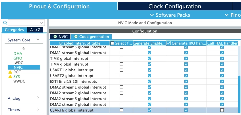

tykhaytschaar
tykhaytschaarBest answer
Jan 8, 2025 5:59 PM UTC
@mƎALLEm
I found the cause, and it was (partly?) my mistake: in the System Core > NVIC > Code Generation tab, the Call HAL handler checkbox for the USART6 Global Interrupt was not checked. After enabling it, the code generation works correctly.
However, there are still a few things I don't understand:
  • How could the checkbox become unchecked without deliberate user interaction?
  • How is it possible that copying another working .ioc file and than modifying some pin names and enabling a timer also resulted in the same issue?
  • How is it possible that the same .ioc file worked correctly for you? (I assume the checkbox is checked in your case if the generation works as expected.)

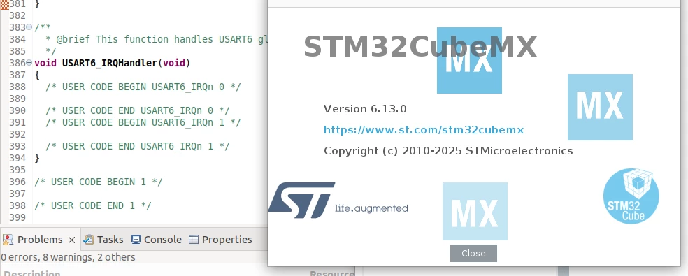

mƎALLEm
Jan 8, 2025 1:36 PM UTC
Hello @tykhaytschaar ,
I'm not reproducing the behavior for both projects and HAL_UART_IRQHandler() is there:
Please use the latest version of CubeMx 6.13.0

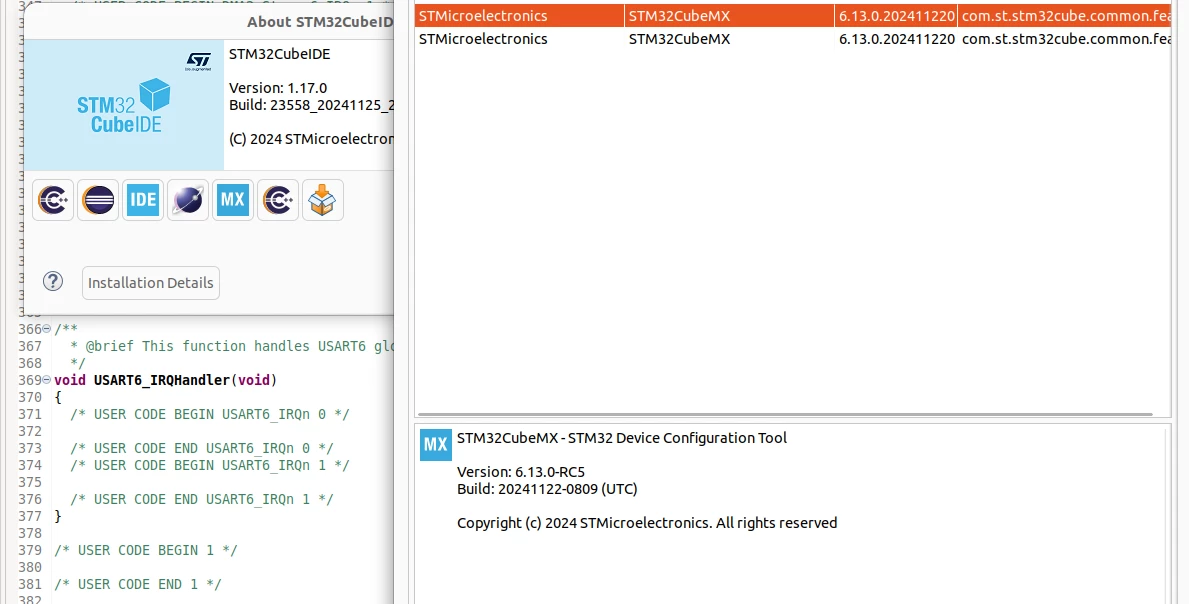

tykhaytschaar
Jan 8, 2025 1:46 PM UTC
Thanks for the prompt response, @mƎALLEm .
In the meantime I tried to generate code on an ubuntu 22.04 machine with fresh installation of cubeIDE.
STM32CubeMX - STM32 Device Configuration Tool
Version: 6.13.0-RCS
Build: 20241122-0809 (UTC)
The issue occurs on this machine also.
Edit:

tykhaytschaar
Jan 8, 2025 2:00 PM UTC
I've downloaded official STM32CubeIDE installer from here: https://www.st.com/en/development-tools/stm32cubeide.html (chose "STM32CubeIDE Generic Linux Installer 1.17" exactly. CubeMX came as part of the IDE, so selecting RCS wasn't my decision.
mƎALLEm
Jan 8, 2025 2:01 PM UTC
Ah! So try to generate the code from the standalone version of CubeMx 6.13.0 and see what happens. It could be an issue in the CubeMx version integrated in the CubeIDE.
tykhaytschaar
Jan 8, 2025 2:17 PM UTC
I installed the standalone version of CubeMX on the ubuntu machine and tried generating the code with it as well. The issue still persists.
