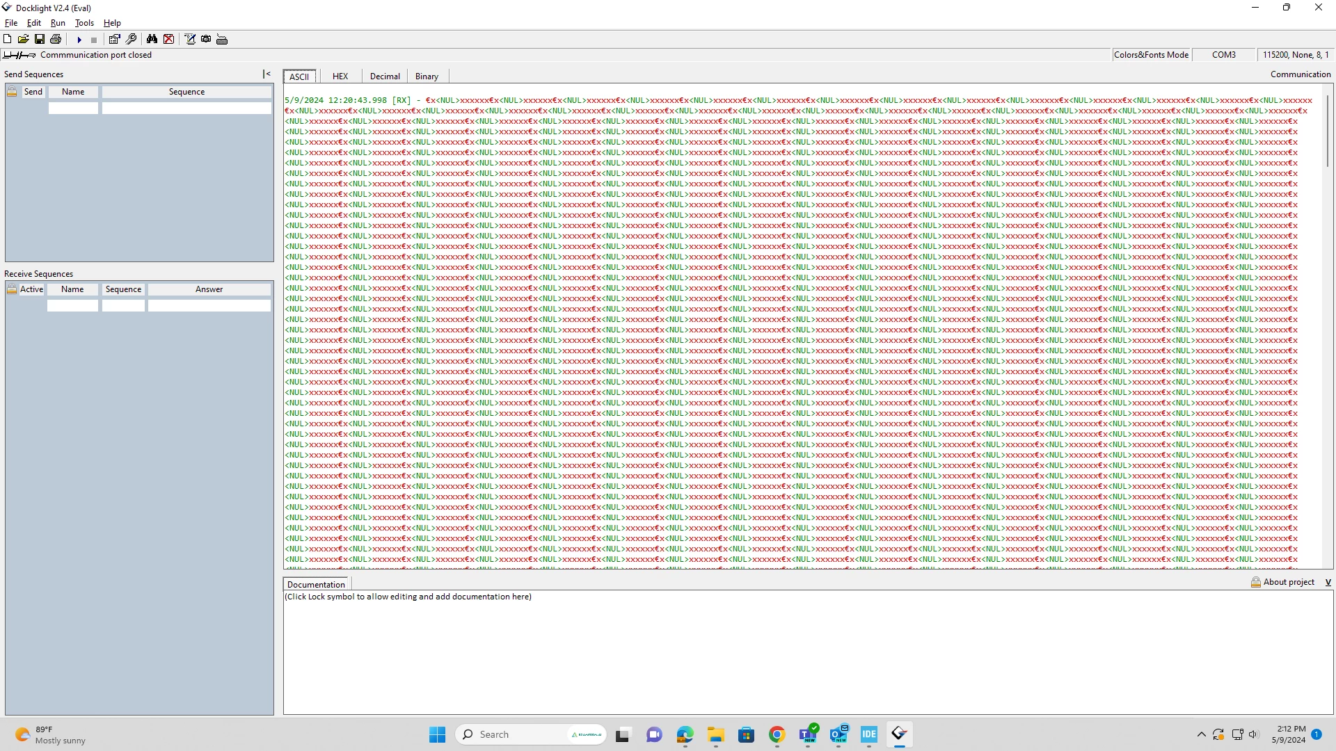

I am attempting bare-metal programming for UART data transmission and reception on the STM32L476RG microcontroller. After transmitting data, observed that the debug terminal is only receiving NULL characters. Please help.

Please describe how the STM32's UART is connected through to your terminal.
What do you mean by that?
Please post a screenshot
https://www.techrepublic.com/article/how-to-take-screenshots-in-windows-10/
Probably the commonest cause of "junk characters" on a terminal is wrong baud rate:
https://learn.sparkfun.com/tutorials/serial-communication/all#:~:text=If%20all%20the%20receiving%20device%20sees%20on%20its%20receive%20line%20is%20garbage%2C%20check%20to%20make%20sure%20the%20baud%20rates%20match%20up

Here is the debug terminal: Screenshot (19).png
