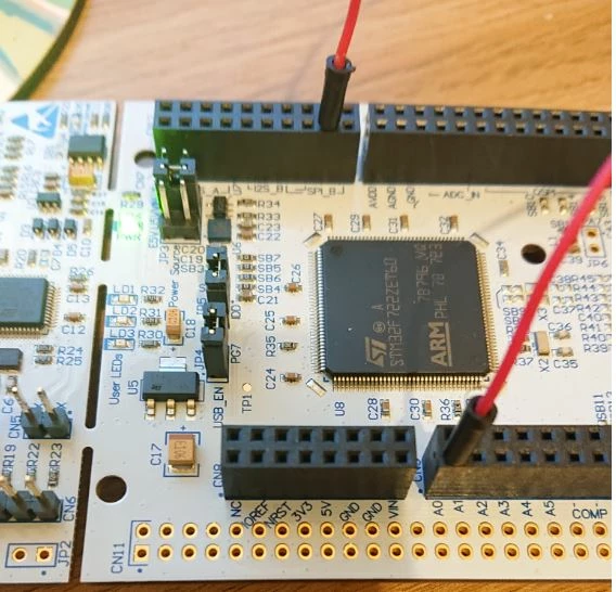

I'm working with the NUCLEO-F722ZE EVB on STM32CubeIDE.
My design has a DAC output connected via a jumper wire to an ADC input (see the red wire in the attached picture.
The DAC is successfully generating a sawtooth wave - verified via an oscilloscope.
However the ADC isn't working properly. I'm using a break point to stop the code and I see "semi constant" values.
By "semi constant" I mean that the reading is changes between compilations but is constant during runtime and seems to be unaffected by the DAC that's driving it.
What am I doing wrong ?

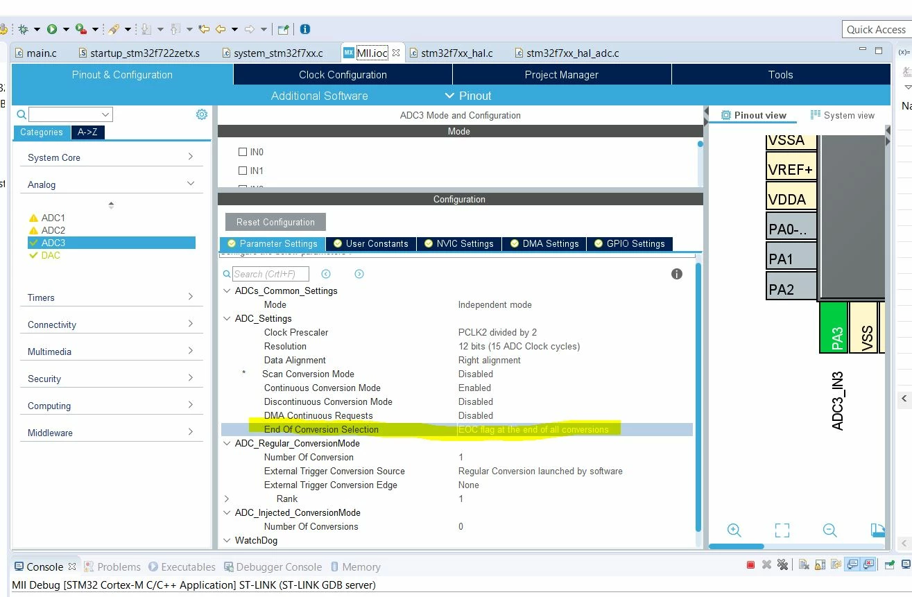

skon.1
skon.1Best answer
Aug 2, 2020 5:06 PM UTC
I fixed it.
What solved the problem is setting the "End Of Conversion Selection" from:
"EOC flag at the end of single channel conversions"
to
"EOC flag at the end of all conversions"

Trt first to use the adc channel that is right where the dac is... No wire needed, and make sure the dac buffer is on. What are the triggers for dac and adc? Pwm from timer? Better use external trigger signals so you can probe them.

"Trt first to use the adc channel that is right where the dac is... No wire needed"
I can use the same pin for DAC and ADC at the same time ?

skon.1AuthorBest answer
I fixed it.
to
skon.1
skon.1Author
Aug 2, 2020 8:10 PM UTC
Can someone explain this ?
