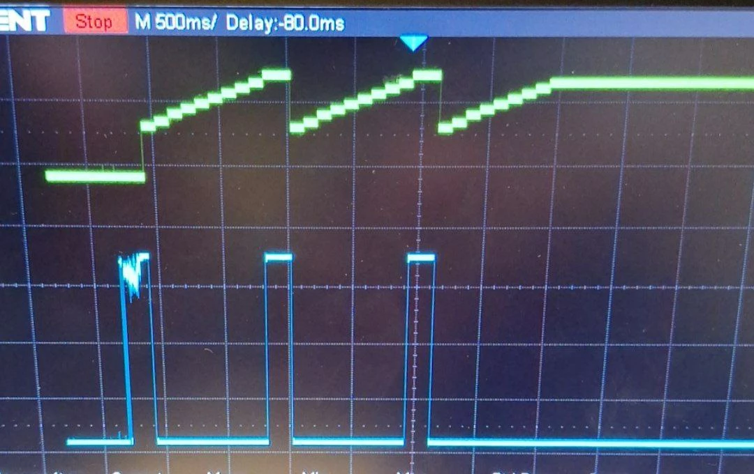

I am using timer 2 for trigger DAC and GPIO to generate analog and digital values.
own timer 2 started with DMA to change ARR by an array.
My GPIO array works well and starting to change from index 0 . but my DAC array start from Index 1.
as you can see, the longest pulse (200ms) in latest DAC value (dac[9] = 4000) instead of (dac[0] = 2000)
time[0] = 200000;
time[1] = 100000;
time[2] = 100000;
time[3] = 100000;
time[4] = 100000;
time[5] = 100000;
time[6] = 100000;
time[7] = 100000;
time[8] = 100000;
time[9] = 100000;
dac[0] = 2000;
dac[1] = 2200;
dac[2] = 2500;
dac[3] = 2700;
dac[4] = 2900;
dac[5] = 3100;
dac[6] = 3300;
dac[7] = 3500;
dac[8] = 3700;
dac[9] = 4000;
pin[0] = 0x0000FFFF;
pin[1] = 0xFFFF0000;
pin[2] = 0xFFFF0000;
pin[3] = 0xFFFF0000;
pin[4] = 0xFFFF0000;
pin[5] = 0xFFFF0000;
pin[6] = 0xFFFF0000;
pin[7] = 0xFFFF0000;
pin[8] = 0xFFFF0000;
pin[9] = 0xFFFF0000;
Best answer by nimaltd
I have fixed.
1) start DAC DMA
2) htim2.Instance->EGR = 0x01;  // trigged event by software
3) start GPIO DMA
4) start TIMER DMA
but why???

I think DAC Trigger Rising edge does not work, it starts on falling edge of TIM2-TRGO.
nimaltdAuthorBest answer
Senior
April 19, 2024
I have fixed.
1) start DAC DMA
3) start GPIO DMA
4) start TIMER DMA
but why???
