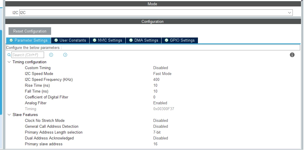

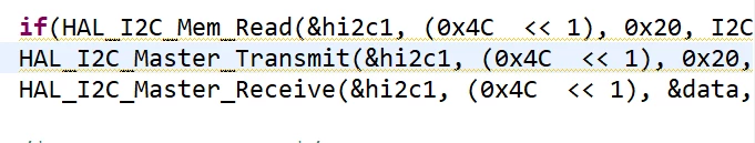

I hope this message finds you well. I am reaching out regarding an urgent matter with my STM32 CubeMX v6.1 project. I have encountered an issue with the I2C functionality that I cannot seem to resolve despite trying various approaches.
The specific problem arises with the following function:
SMazu3_0-1713767509891.pngSMazu3_1-1713767529673.pngSMazu3_2-1713767543607.pngSMazu3_3-1713767569402.png
I have attempted to implement this function across different STM microcontroller units, including STM32WB10, STM32F750, and STM32F103, but unfortunately, the issue persists consistently across all of them. It's worth noting that I have verified the hardware compatibility by successfully testing it with Arduino and ESP32 platforms.
Given that I have a project deadline looming, I urgently require your assistance in resolving this matter. Any guidance or insights you can provide would be greatly appreciated.
Thank you very much for your prompt attention to this matter. I look forward to your response.

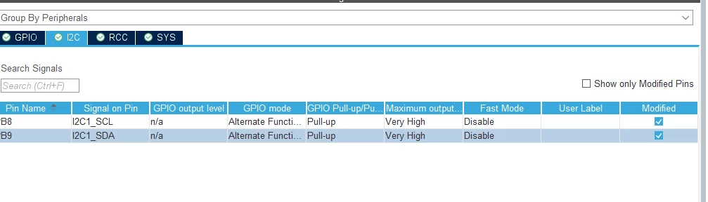

What's the first bit map of.code fragment about?
Probably issue not where you're looking.
State slave part and connectivity.
Don't use internal pull up on AF OD. Use an external pull up likely in 1K5 to 2K7 range.

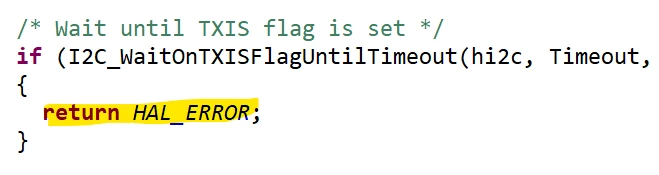

"if (I2C_WaitOnTXISFlagUntilTimeout(hi2c, Timeout, Tickstart) != HAL_OK)
return HAL_ERROR;
this function is come true.

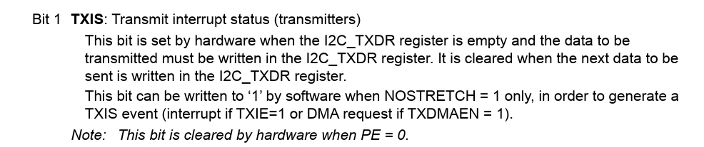

@SMazu.3  , what i dont understand :
you call (blocking) HAL_I2C_Master_Transmit() , that will return success or error
and then (i assume - you dont show your program) I2C_WaitOnTXISFlagUntilTimeout() to check --- what ?
TXIS flag ?
-> transmit interrupt status : but you dont use interrupt call at all.
I would say: just leave it away or use interrupt I2C calls.

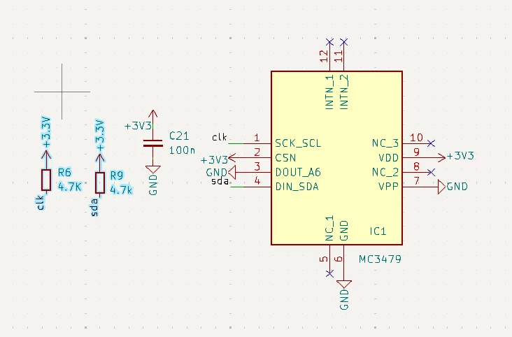

already using 4k7 with 3v3

MC3479 It's MEMSIC accelerometer
I2C: supports 400 KHz and fast mode +. Has two interrupt pins with programmable mode/polarity.
The 7-bit address can be 0x4C or 0x6C (see the PDF pg, 35).

hw is working i test that with Arduino and esp32 and esp8266,
stm code is no working. WaitOnTXISFlagUntilTimeout come Hal_Error very time.
with Master mode Slave mode and and all i2c code by cube ide or cube max have this problem
with stm32wb10 stm32f103. and stm32f750

Consistency is good, it hints that you're doing something generally wrong for the ST library. Check that you pass the I2C address in correct format.

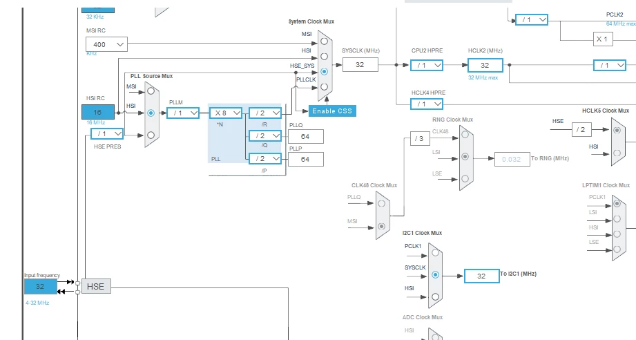

Get a scope or analyzer on the signals and understand what's happening there.
Show ALL initialization code for I2C and the pins. Hard to debug with level of detail presented. You'll need to dig until you understand the problem.

Create a simple i2c code in stm32 cube mx with default settings.
Run a simple hal_i2c_tresmit code. And check this code is working on cube ide.
In my case it return me hal_error.

Ok. Then can  you please change a bit your simple project and instead of transmit call HAL_I2C_IsDeviceReady. Will it return error too? Will it succeed if you change address to 0x6C?

Then the electric connection of the I2C device is not good. It does not respond to either of its two possible addresses.
To be sure, do another try with read access: HAL_I2C_IsDeviceReady with addresses (0x4C <<1 | 1) and (0x6C <<1 | 1)
