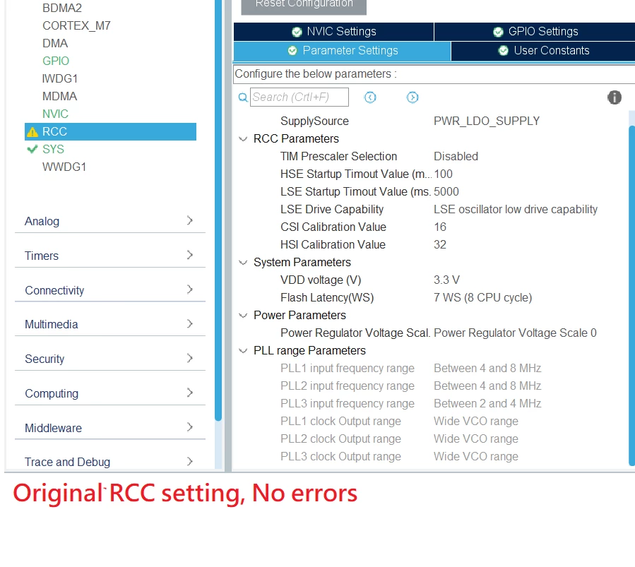

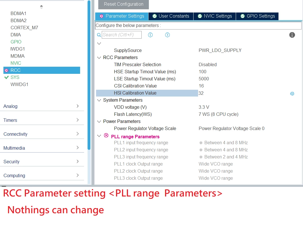

0693W000007CXBnQAO.pngAfter I import a STM32H7A3ZIT6 from an old STM32H7A3ZIT6 project
cchen.12
cchen.12Author
Jan 25, 2021 1:31 PM UTC

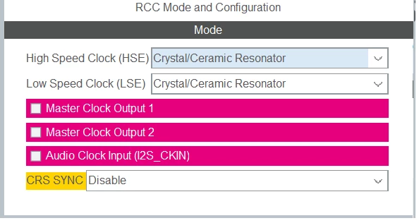

My RCC settings,It seems OK while disable HSE and LSE
