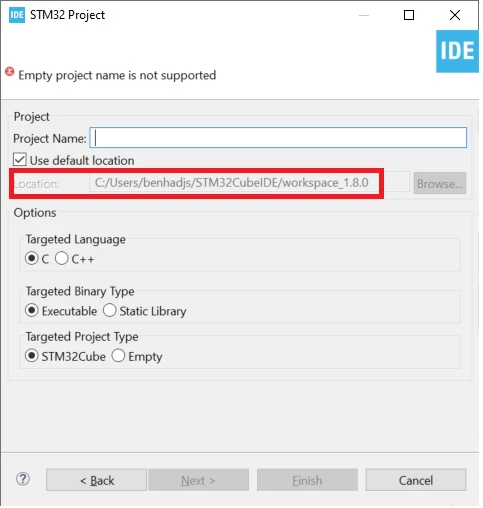

STM32CubeIDE\workspace_1.8.0 does not exist
STM32CubeIDE\workspace_1.3.0 does, but has an updated data of 8/11/2021
Can't find the plugin log file
CubeMX standalone does not generate the extra file.
Running the standalone version after running the IDE version, and then refreshing (F5) causes the extra file to vanish.
I've been updating the IDE as needed, but I'm not sure where the 1.8 workspace is now.
Could that be a problem?

The workspace is where the project is saved, when you create a new project using CubeIDE, either you use the default location or you can change it (please refer to the attachment).
0693W00000KZZO8QAP.pngThe workspace can be changed by selecting [File]>[Switch Workspace], So it is not an issue when the workspace_1.8.0 does not exist, please check where your projects are saved and you will find the .metadata folder.
Did the project compiled correctly when you used the CubeMX standalone and after refreshing the project ?
Please make sure that the workspace and the project names must contain only ascii characters. This is also valid for the path to the workspace.
Could you please try to re-install CubeIDE and reproduce the issue ?
