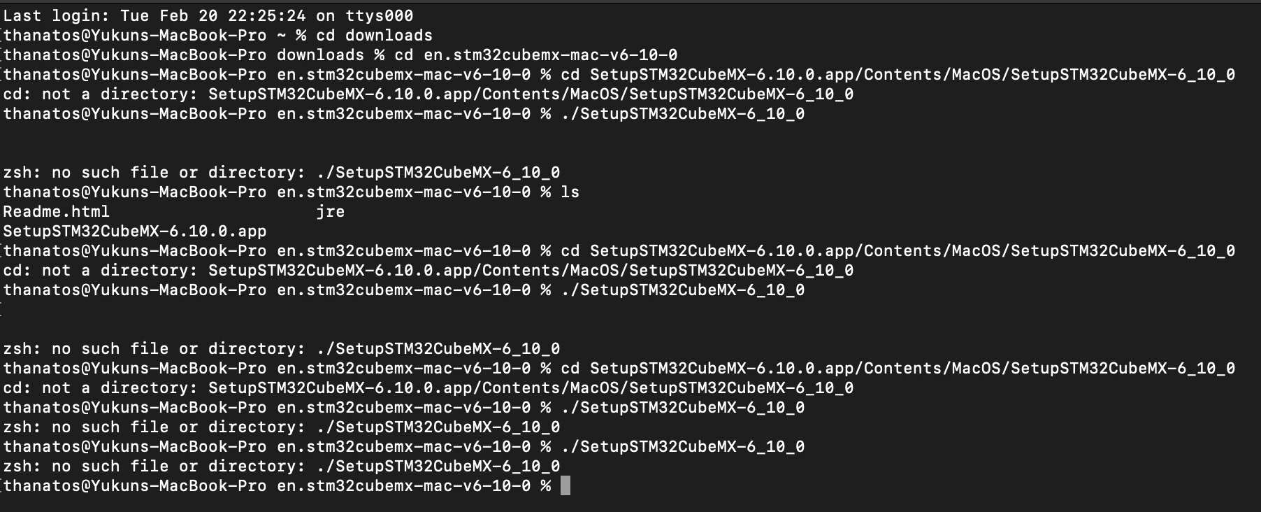

Visitor II
February 21, 2024
I got the same issue, and followed up your instruction, but I still get no luck. this is what I can show.
Please help.
Thank you
Thomas

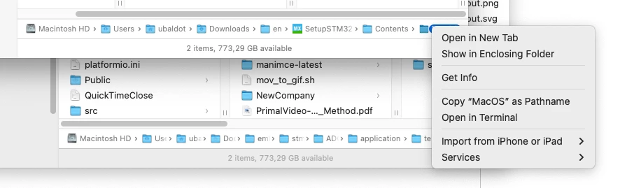

ubaldotAuthor
February 21, 2024
Try to right click on the CubeMX setup icon/Show package content and then reach the final destination through finder. Once there, right click on the path shown below and click open in Terminal.
