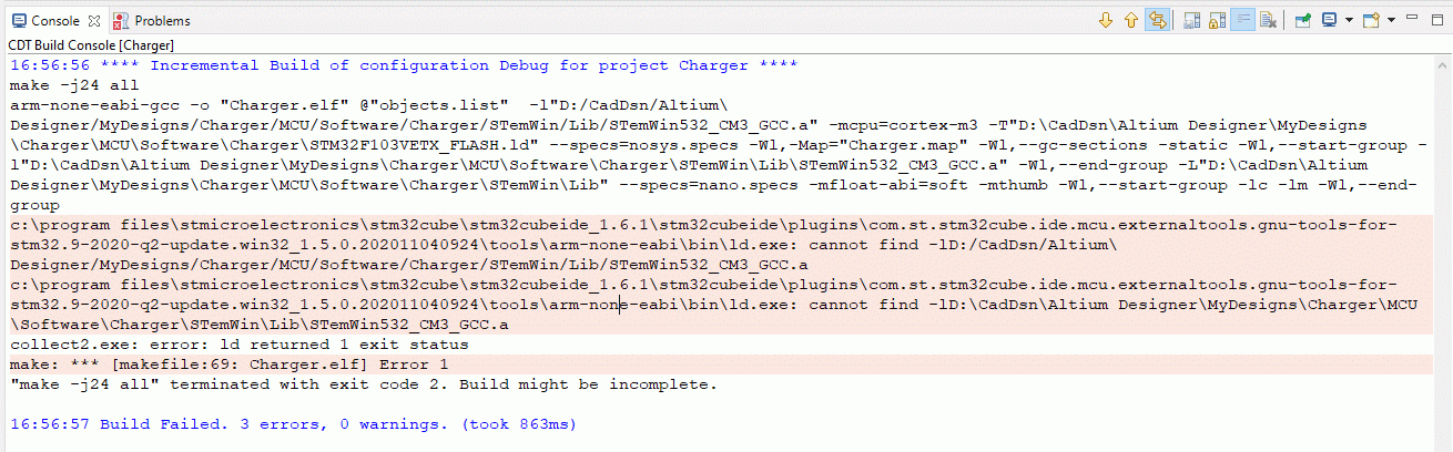

CubeMX v6.2.1, CubeMX IDE v1.6.1, STM32F103VET6 and STemWin v5.32: cannot connect STemWin532_CM3_GCC.a library
The linker produce a error "cannot find library". See pic. However, I trying to change the lib path to haven't any spaces inside. This not help.

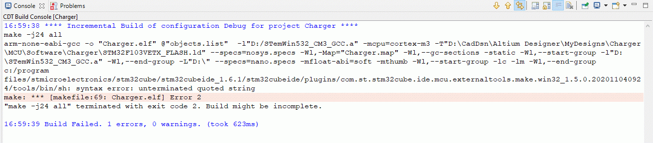

Then I change the lib path to my disk root D: folder and this generate next 'sh' error.

I fix this problem. The STemWin library *.a files must be connected in CubeIDE (based on Eclipse) as 'other linker object' : Project/Properties/CC++ Build/Settings/Tool Settings/GCC Linker/Misc/Additional Object files. Connecting it other way does not work! Have a 3 days delay to fix this issue...
