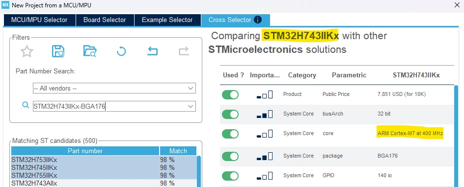

Cross selector displays operation frequency of STM32H743II as 400MHz, but it should be 480MHz. I've refreshed all data and databases but the result is the same. Is there a known solution for this issue?

Hello ​@recepsah
This issue has been fixed in the latest version of STM32CubeMX 6.18.0
Download STM32CubeMX6.18.0 from  here
