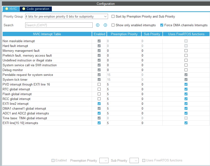

CubeMX v.6 reset preemtion priority to 0 in projects whith FreeRTOS.
Hi !
What a trouble in new version of CubeMX 6.0 ?
Why :

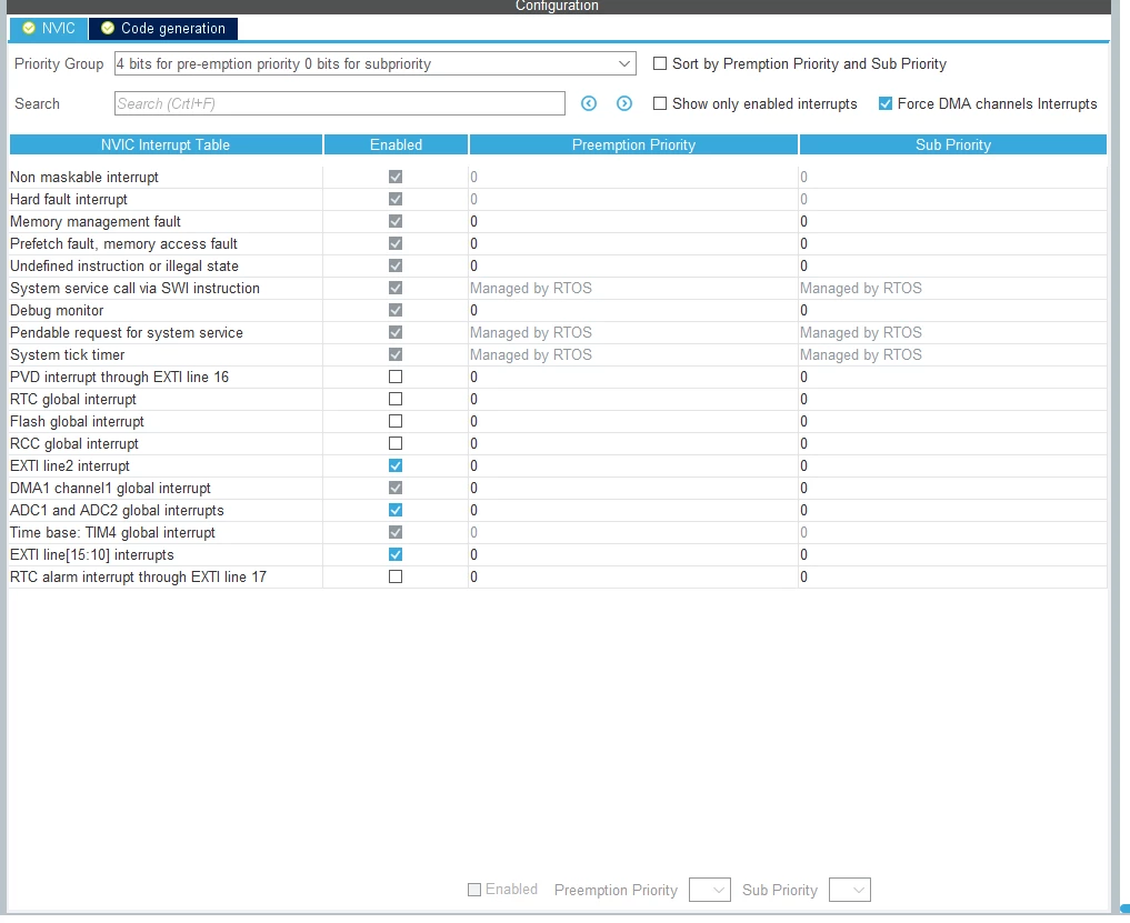

1. CubeMX v.6 reset preemtion priority to 0 from any nonzero values in projects whth FreeRTOS when to migrate from old version?
This is original setting:
this is migrated to 6:
2. Where a checkbox "Uses the FreeRTOS functions" in NVIC tab ?
STM Employes, answer please, another way need to return to old stable version 5.6.1.

My problem was closed in version 6.0.1 CubeMX.

Glad to know that your problem is already resolved thanks to 6.0.1 release of STM32CubeMX.
A similar issue was already reported in this discussion and confirmed by ST.
