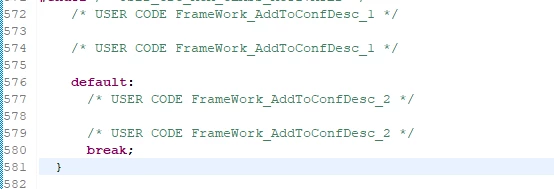

  3. USBX/App/ux_device_descriptors.c: The user code block USER CODE FrameWork_AddToConfDesc_1 doesn't work properly (during IOC regeneration, the code inside of this block is always removed). This happens probably because the closing comment miss END keyword

I also had your problem (3).  I fixed it by modifying ux_device_descriptors_c.ftl, adding the 'BEGIN' and 'END' keywords to the USER CODE blocks that I care about.  That fixed my problem, and I noticed there were several other blocks with the same error that I don't care about (yet):
