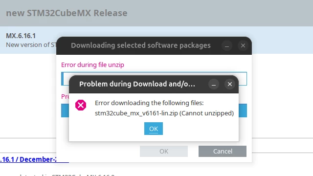

CubeMX upgrade unzip failure due to program folder change
1. Run StmCubeMX and then chose upgrade in Ubuntu
2. After download it error with something alike it cannot unzip the file.
Reason:
1. it seems CubeMx uses the .installationinformation hidden file in its folder to find the installation folder.
INSTALL_PATHt\00$.....<your patch>/STM32CubeMXt\
These are settings  in a binary format, so there are some weird character. Anyhow it cannot be changed by user.
Solutions:
1. Move CubeMX back to where is was installed (not desired) after upgrade, move it back where  it is desired.
2. Remove and Reinstall CubeMX
Suggested fix:
1. Make CubeMx upgrade process install folder agnostic.

debugging
debuggingAuthor
Lead
February 17, 2026
ubuntu 25.10.
1. move cubeMX folder to another location
2. run from the new location
3. run upgrade. fails
4. move folder back to original location
5. run upgeade. passes.
