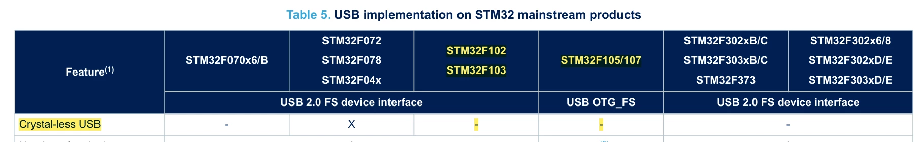

CubeMX will allow you to use HSI for USB on chips which support crystal-less USB such as the STM32H7 or STM32U5 series and others. The STM32F1 is not one of these and does not support crystal-less USB.
Introduction to USB hardware and PCB guidelines using STM32 MCUs - Application note
You can hardwire it to use HSI in code if you want and cross your fingers.

CubeMx is used by newbies and professionals. The HSI is not recommended for USB usage for some STM32 MCUs that's why it's prohibited in CubeMx in your case. In Nucleo board you can either add a crystal or simply use STLINK MCO as clock source for HSE in Bypass mode for your MCU target.
For example for the case of NUCLEO having STLINK V3 version, you can refer to this article on how to use an accurate STLINK MCO as clock source for the target MCU.
