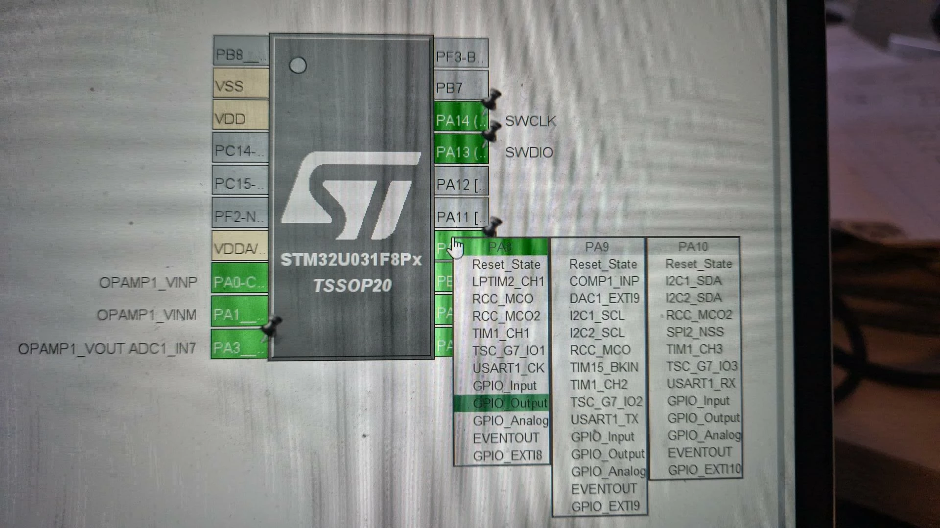

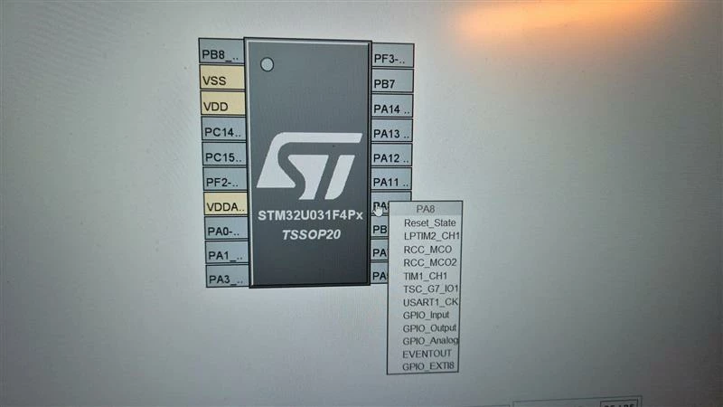

Inside Cube config, i do not get the other internal connected pins on pin 14, only PA8... in older versions it was available.
The chip is STM32U031F8...
What do i do wrong.. i need to use the uart_tx function on pin 14...
Thank you
Old version from Cubeide...
New version from Inet : 6.16.1
Souhaib MAZHOUDBest answer
February 18, 2026
Hello @KJeps.3
I have raised this issue internally to the dedicated team for fix, (Ticket 227473 This is an internal tracking number and is not accessible or usable by customers.)
As a temporary workaround, I suggest that you copy the generated code of USART from the old project or to add this code manually to stm32u0xx_hal_msp.c :
void HAL_UART_MspInit(UART_HandleTypeDef* huart)
 /* Peripheral clock enable */
 __HAL_RCC_USART1_CLK_ENABLE();
 __HAL_RCC_GPIOA_CLK_ENABLE();
 /* USER CODE BEGIN USART1_MspInit 1 */
 GPIO_InitStruct.Pin = GPIO_PIN_9;
 GPIO_InitStruct.Alternate = GPIO_AF7_USART1;
 HAL_GPIO_Init(GPIOA, &GPIO_InitStruct);
 /* USER CODE END USART1_MspInit 1 */
 Also ensure to keep your custom code inside /* USER CODE BEGIN ... */ / /* USER CODE END ... */ so that CubeMX won’t overwrite it.
BR, Souhaib

I just created the project in freshly installed cubemx, and pushed the pin... the 2 other IO pin connections do not pop up...
I have now tried to enable USART, seems not to change anything...

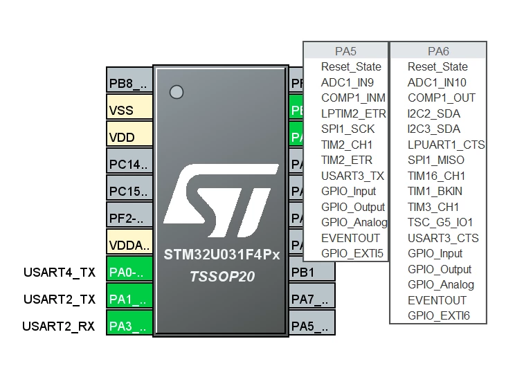

For pin PA5 it seems to work ok to show more IO:

Hello @KJeps.3
To use the alternate functions of PA9 and PA10, you can use the remapping option under SYS as follows:
As it is possible to use PA9 instead of PA11 and PA10 instead of PA12. (you can use USART1_TX with pin15)
For Pin14 I will check internally with dedicated team to investigate the missing of the other function.
KR, Souhaib
