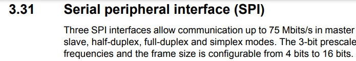

STM32G491xC   ds :
But in Cube can only select 8 or 16 bits, i can confirm.
Obviously a bug.
@Ghofrane GSOURI , would you report this ?

Hello @decalvus and @AScha.3
Thank you for your contributions and for your detailed explanations,
I confirm the issue on my side, it has been reported to STM32CubeMX development team .
Internal ticket number: 170304(This is an internal tracking number and is not accessible or usable by customers).
