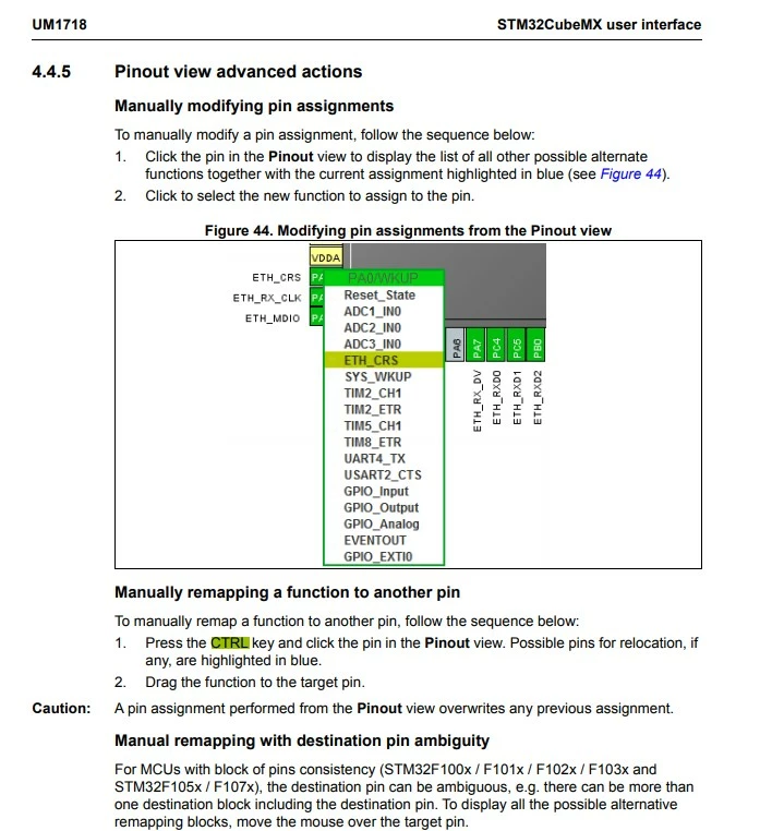

Works like a charm for me if IDE 1.6.0 or MX 6.2.0 at least. I've just followed user manual:
0693W000008ySL4QAM.jpgOnly variation is on my side compliant target pins are all highlighted in black. Blue is allocated to pin I'm finally selecting to perform my remapping.

Thank you Cartu32 for replying.
Foer me it does not work. Ctrl/Click on a configured pin (either PA7 or PD7), but the other one is NOT highlighted in blue or black.
Perhaps I am color blind.
*UPDATE* After several tries, I clicked in some special way, and two alternative pins highlighted in black. But I cannot reproduce it again.
