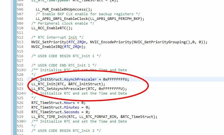

I'm using CubeMX 5.2 to initialize the RTC of my STM3210C card.
I activated HSE as a source for the RTC:0690X000008ihJZQAY.jpg

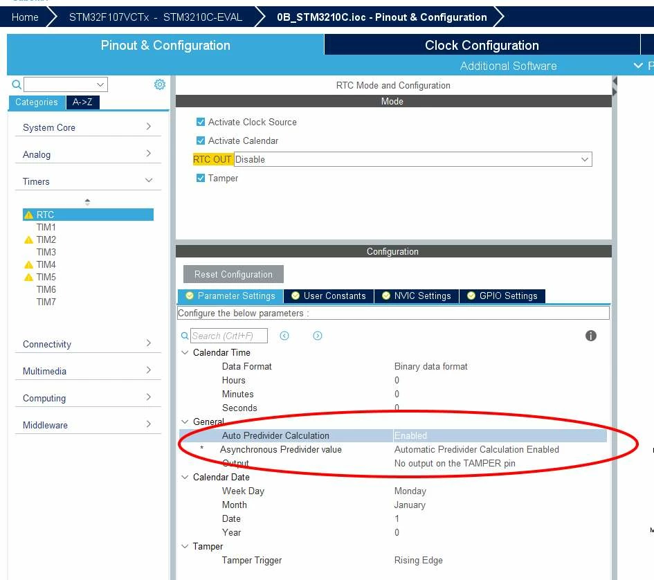

and on cubeMX I have enabled the Auto predivider calculation:
The generated code is:
The value of AsynchPrescaler is at 0xffffffff...

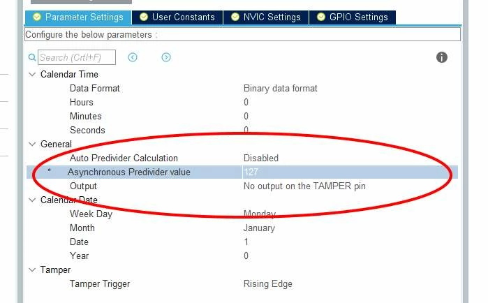

then, on cubeMX I disabled the Auto predivider calculation:

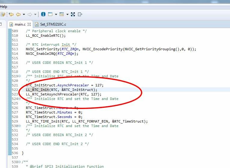

Now, in both cases the Synchronous predivider value is not set and it is not possible to have the 1Hz correct frequency at the RTC counter.
