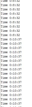

I'm new STM32L072 (Discovery Kit) and I had generated a code to run the RTC using the LSI Clock and displaying the values via UART2 but the RTC values are not incremented even if rest button is pressed, Then I deactivated the calendar and observed the values via UART2 and the output is same but when i reset the board then RTC value is getting updated as shown in below, please anyone suggest me to solve the issue.

I don't know why this is occurring, I don't use CubeMX, and really have little context here to work with, the code and settings of the RTC would be where I'd start.

Thanks for the reply, I had attached the initialisation code of the RCC and RTC. As i'm new to this MCU i tried all possible ways but still i'm facing same issue.
void SystemClock_Config(void)
 RCC_PeriphCLKInitTypeDef PeriphClkInit = {0};
 /**Configure the main internal regulator output voltage
 __HAL_PWR_VOLTAGESCALING_CONFIG(PWR_REGULATOR_VOLTAGE_SCALE1);
 /**Initializes the CPU, AHB and APB busses clocks
 RCC_OscInitStruct.OscillatorType = RCC_OSCILLATORTYPE_LSI|RCC_OSCILLATORTYPE_MSI;
 RCC_OscInitStruct.LSIState = RCC_LSI_ON;
 RCC_OscInitStruct.MSIState = RCC_MSI_ON;
 RCC_OscInitStruct.MSICalibrationValue = 0;
 RCC_OscInitStruct.MSIClockRange = RCC_MSIRANGE_5;
 RCC_OscInitStruct.PLL.PLLState = RCC_PLL_NONE;
 Error_Handler();
 RCC_ClkInitStruct.SYSCLKSource = RCC_SYSCLKSOURCE_MSI;
 RCC_ClkInitStruct.APB1CLKDivider = RCC_HCLK_DIV1;
 RCC_ClkInitStruct.APB2CLKDivider = RCC_HCLK_DIV1;
 if (HAL_RCC_ClockConfig(&RCC_ClkInitStruct, FLASH_LATENCY_0) != HAL_OK)
 Error_Handler();
 PeriphClkInit.PeriphClockSelection = RCC_PERIPHCLK_USART2|RCC_PERIPHCLK_RTC;
 PeriphClkInit.Usart2ClockSelection = RCC_USART2CLKSOURCE_PCLK1;
 PeriphClkInit.RTCClockSelection = RCC_RTCCLKSOURCE_LSI;
 if (HAL_RCCEx_PeriphCLKConfig(&PeriphClkInit) != HAL_OK)
 Error_Handler();
static void MX_RTC_Init(void)
 /* USER CODE BEGIN RTC_Init 0 */
 /* USER CODE END RTC_Init 0 */
 /* USER CODE BEGIN RTC_Init 1 */
 /* USER CODE END RTC_Init 1 */
 /**Initialize RTC Only
 hrtc.Instance = RTC;
 hrtc.Init.HourFormat = RTC_HOURFORMAT_24;
 hrtc.Init.AsynchPrediv = 124;
 hrtc.Init.SynchPrediv = 295;
 hrtc.Init.OutPut = RTC_OUTPUT_DISABLE;
 hrtc.Init.OutPutRemap = RTC_OUTPUT_REMAP_NONE;
 hrtc.Init.OutPutPolarity = RTC_OUTPUT_POLARITY_HIGH;
 hrtc.Init.OutPutType = RTC_OUTPUT_TYPE_OPENDRAIN;
 if (HAL_RTC_Init(&hrtc) != HAL_OK)
 Error_Handler();
 /* USER CODE BEGIN RTC_Init 2 */
 /* USER CODE END RTC_Init 2 */
