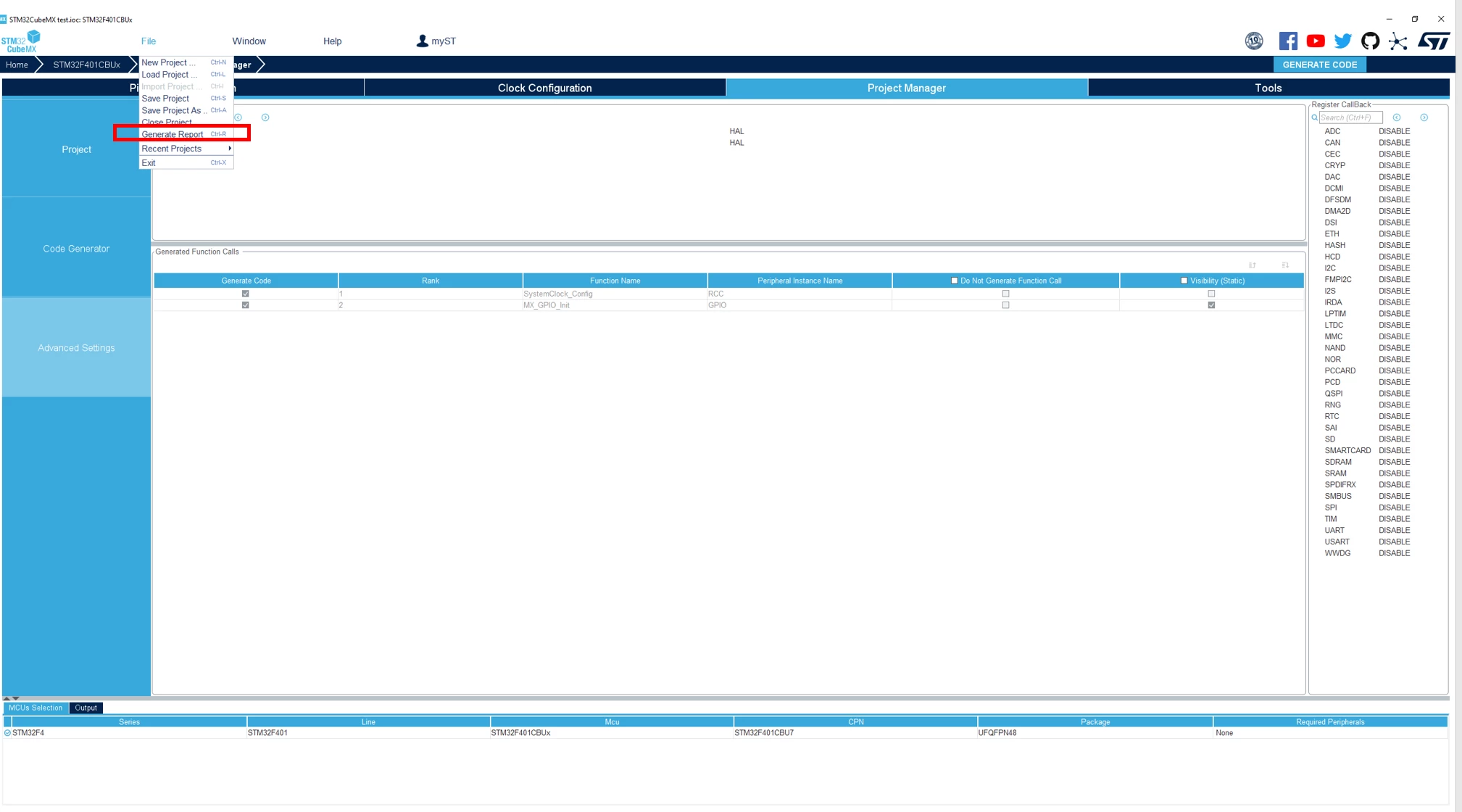

a) looking at UM1718 Rev 41 (July 2023) "11.4 Generating the report" there should be a button in the "Project Manager" Tab to start a export. I don't remember seeing it before and in "STM32CubeMX - STM32 Device Configuration Tool Version: 6.9.0-RC9 Build: 20230705-1724 (UTC)" in updatetd CubeIDE and "STM32CubeMX Version 6.9.0" separate install, both Windows I don't see the button.

Hello @_richard
In order to generate a report you need to follow those steps:
-Select File then click on Generate report
Thx

Hi Ghofrane,
thanks for the hint. i can confirm that for cubemx 6.9.1 the menu entry exists.
that menu entry is not accesible in cubeide as far as i see -> reports only from cubemx.
