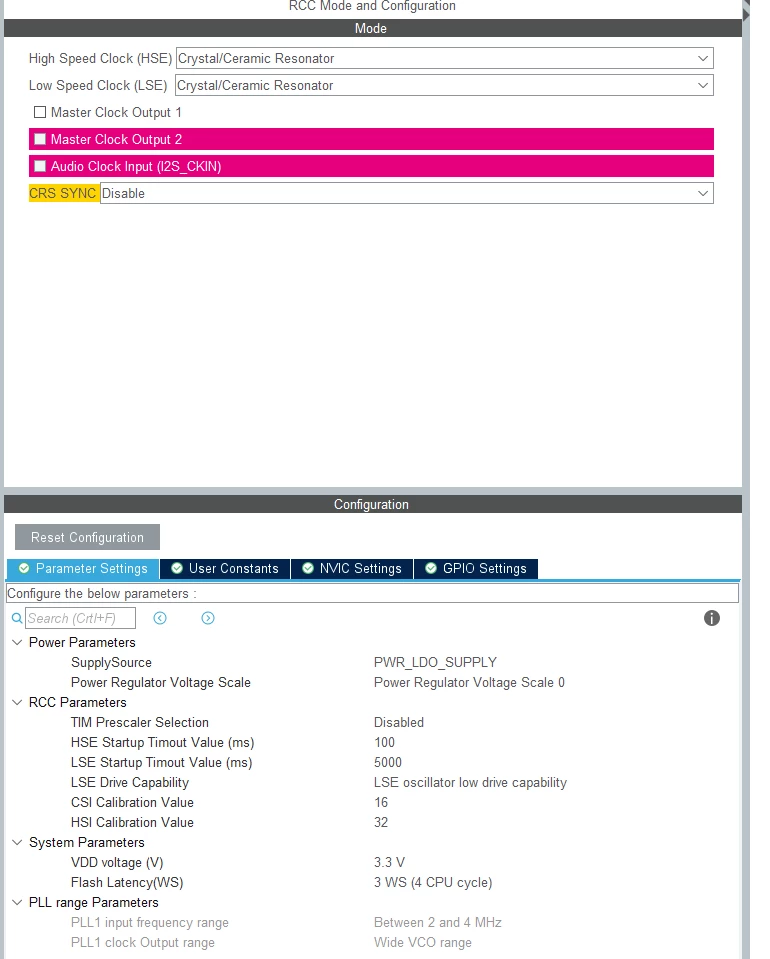

We have been using STCubeMx(v6.2.1) to generate our system initialization code. We started a new project for an stm32H7A3xx MCU.
But with the auto-generated code, it fails on the HAL_RCC_ClockConfig->HAL_InitTick->HAL_SYSTICK_Config.
We tried different clock configurations (lower freq., different prescalers) but it resulted in the same fault.
Any idea where the problem is?
Thanks in advance,
Adria Terrades

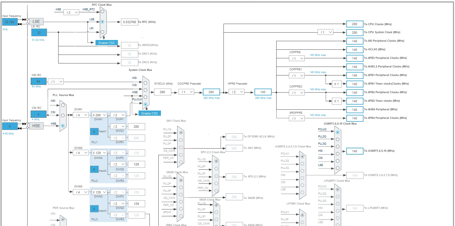

Aterrades
AterradesBest answer
Jun 7, 2021 6:24 AM UTC
At the end, we ended up remaking the project and little by little and it solved itself. I suppose something messed up with the previous auto-generation.
Thanks for your responses,
AT

Jun 4, 2021 2:54 PM UTC
If you have uwTickFreq = HAL_TICK_FREQ_10HZ, your reload won't fit in 24 bits. Use a faster frequency.
If that's not it, attach your IOC if you can. Verify SystemCoreClock gets set to 280e6. See what uwTickFreq is equal.
