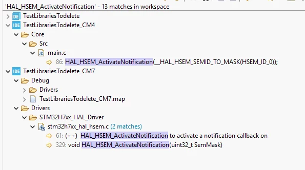

Also, I did a serach and it looks like stm32h7xx_hal_hsem.c is present on the CM7 core but was removed in the CM4 by the .ioc (I did not add/delete any files manually):
Hope this helps, anything else please let me know.

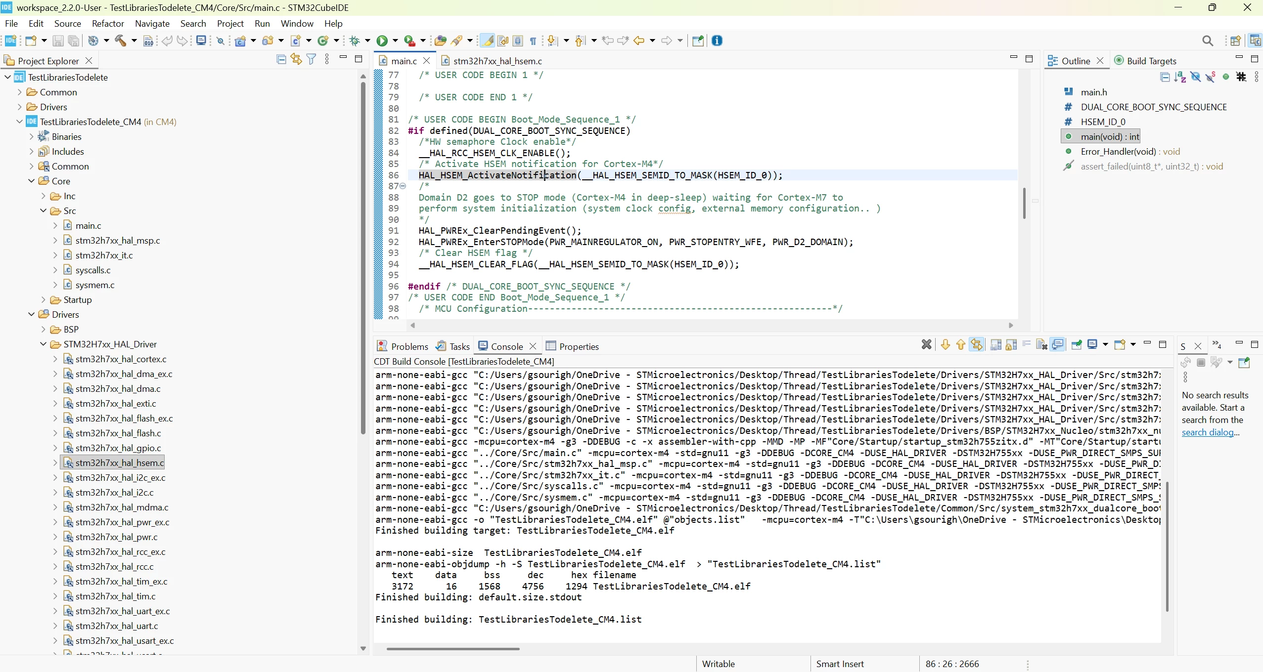

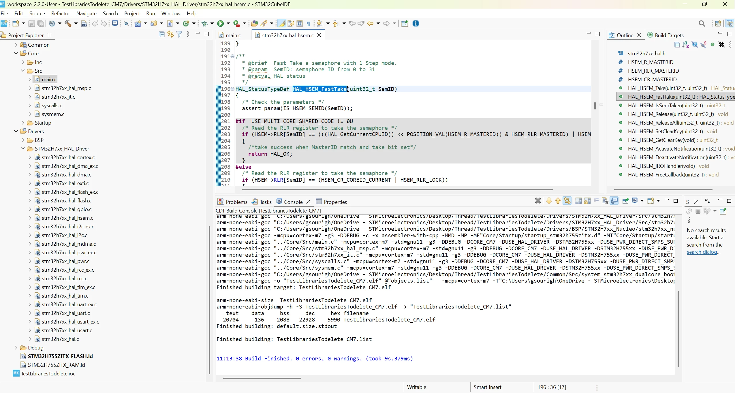

I used the provided IOC to generate the code using STM32CubeMX6.18.0 , the build has been finished successfully in CM4
and the  stm32h7xx_hal_hsem.c  does exist in both CM4 and CM7
So could you please copy the .ioc file alone into a new empty project folder, open it with STM32CubeMX6.18.0 , and regenerate the project in a new workspace.
