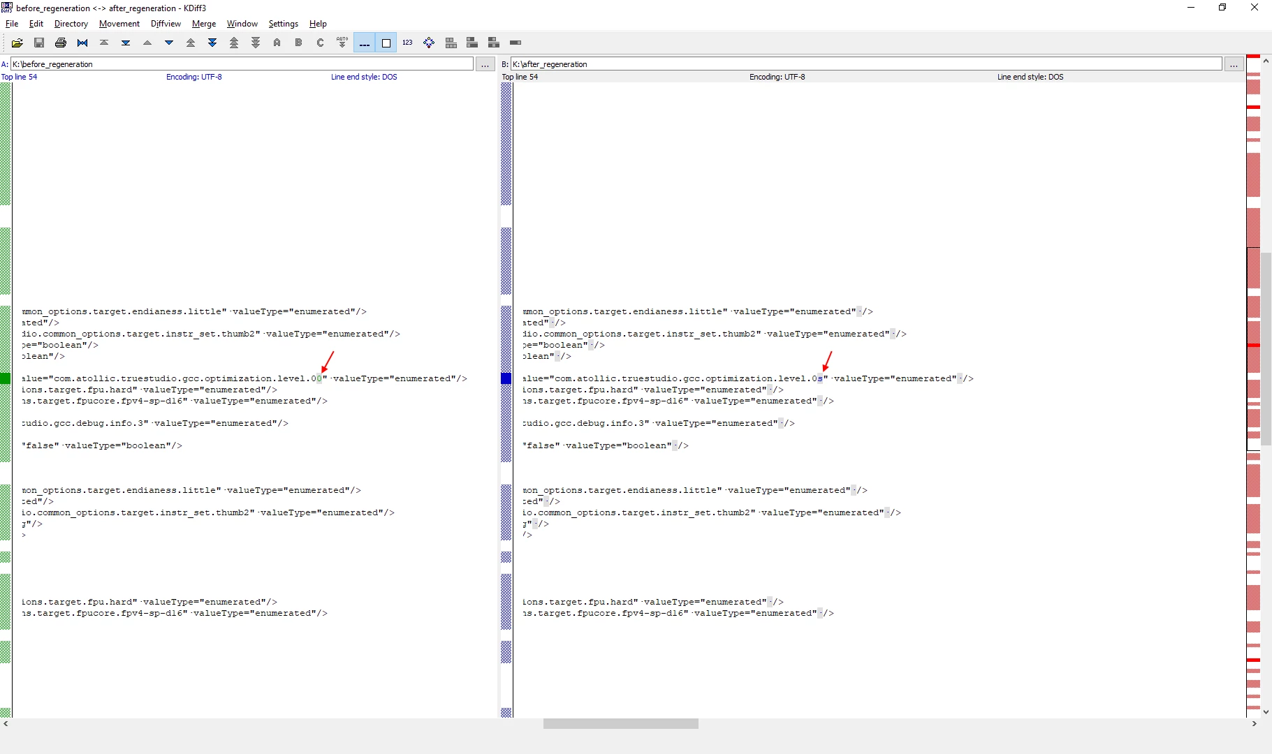

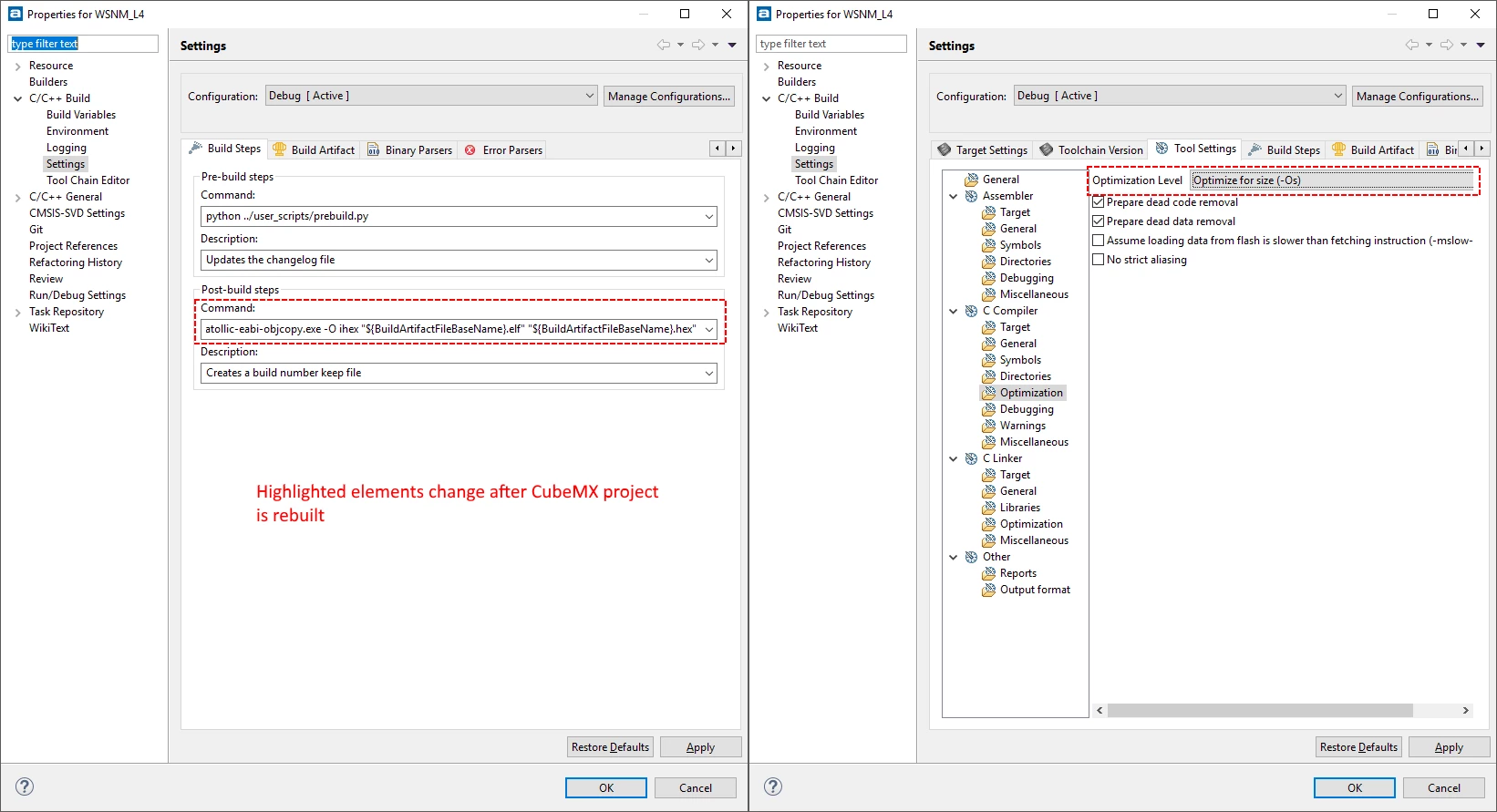

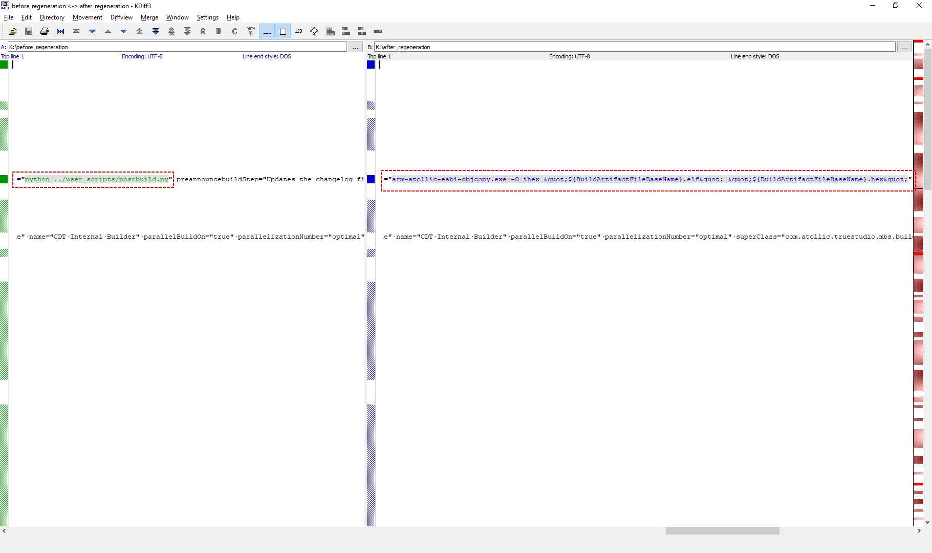

I have noticed the following bug: Apart from that each time I regenerate the project in CubeMX, my truestudio project's optimization flag gets reset (this bug exist for years now), I have just noticed recently that my post build script entry gets reset, to the state before regeneration as well.
Each regeneration there are always weird little changes with spacec and etc. in the project... But that doesn't interfere much. The worst problem is the one above. Using kdiff I compared the .cproject files before and after regenaration, the differences are there:
I can provide further information if needed, can anyone confirm?
