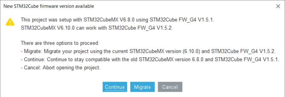

I open project which was created with CubeMX in version 6.8.0 and get pop-up window:

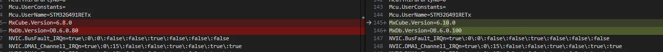

I click continue and project opens but when I just save project even without changing anyting Cube version for the project changes to 6.10.0.
I can see the change in .ioc file immediately:
How can prevent CubeMX from changing version?

CubeMX recognises that a newer firmware may be available and therefore offers to migrate. A click on Continue then continues the project with the previous firmware version.
However, as soon as you save the project, the current version number of CubeMX is written to the IOC, even if no other changes have been made.
If you want the IOC to remain unchanged, you should not save the project.

If I choose continue then I expect project to stay compatible with last Cube version as proposed by Cube with "continue" option. I think that's the purpose of "Continue" option. If it still changes version to newer even If I choose "Continue" then what's the purpose of this option?

As I said, Continue does not refer to the version number of CubeMX, but to the firmware version. As long as you use the previous (frozen) firmware, the generated programme will also remain identical.
When you generate code, the project is automatically saved. This actually makes sense so that the generated source code framework matches the IOC that is then saved. The CubeMX version has no effect on the generated code and does not appear there.

It was just confusing since in prompt window there is information of staying compatible also with CubeMX version and because earlier I haven't have such case that CubeMX version is changed in .ioc and because my collogues which are working on the same file also don't have it changed.
