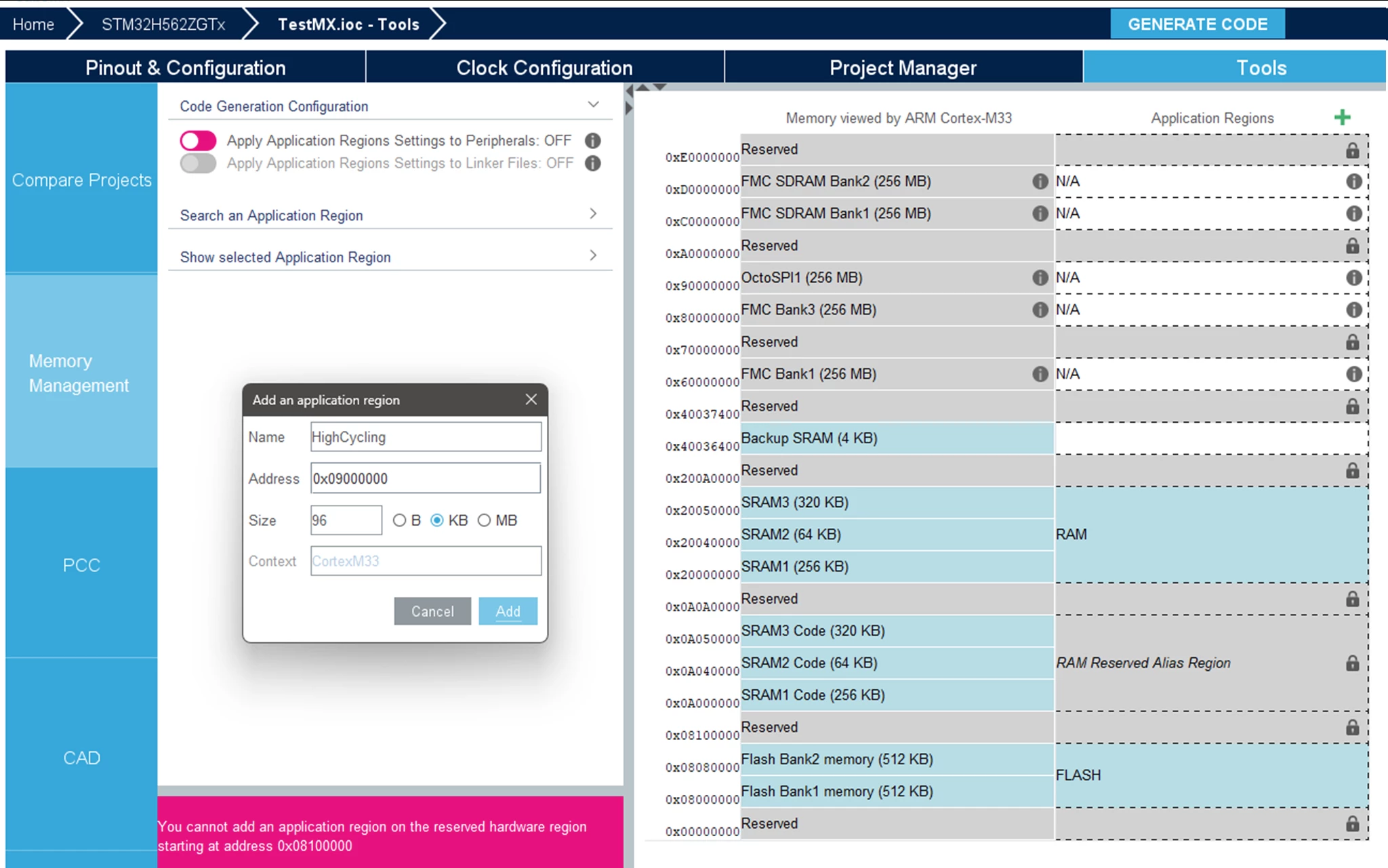

Hi
According to the reference manual the high-cycle capable Flash of a STM32H562 is mapped to the address 0x0900_0000 to 0x0901_7FFF. The Memory Management Tool of CubeMX does not allow me to generate a Region in this address range (see Error below). Is this correct or should CubeMX not allow the generation of a memory region in this range? The Flash Option Byte was configured for the use of the high-cycle Flash.
As a work around I can of course manually edit the linker script.
I use STM32CubeMX Version 6.14 with the Firmware Package V1.5.0 to generate a STM32CubeIDE project on Windows 11.

@Ghofrane GSOURI I just tried the new STM32CubeMX 6.15., and at least in my current project the issue is fixed.

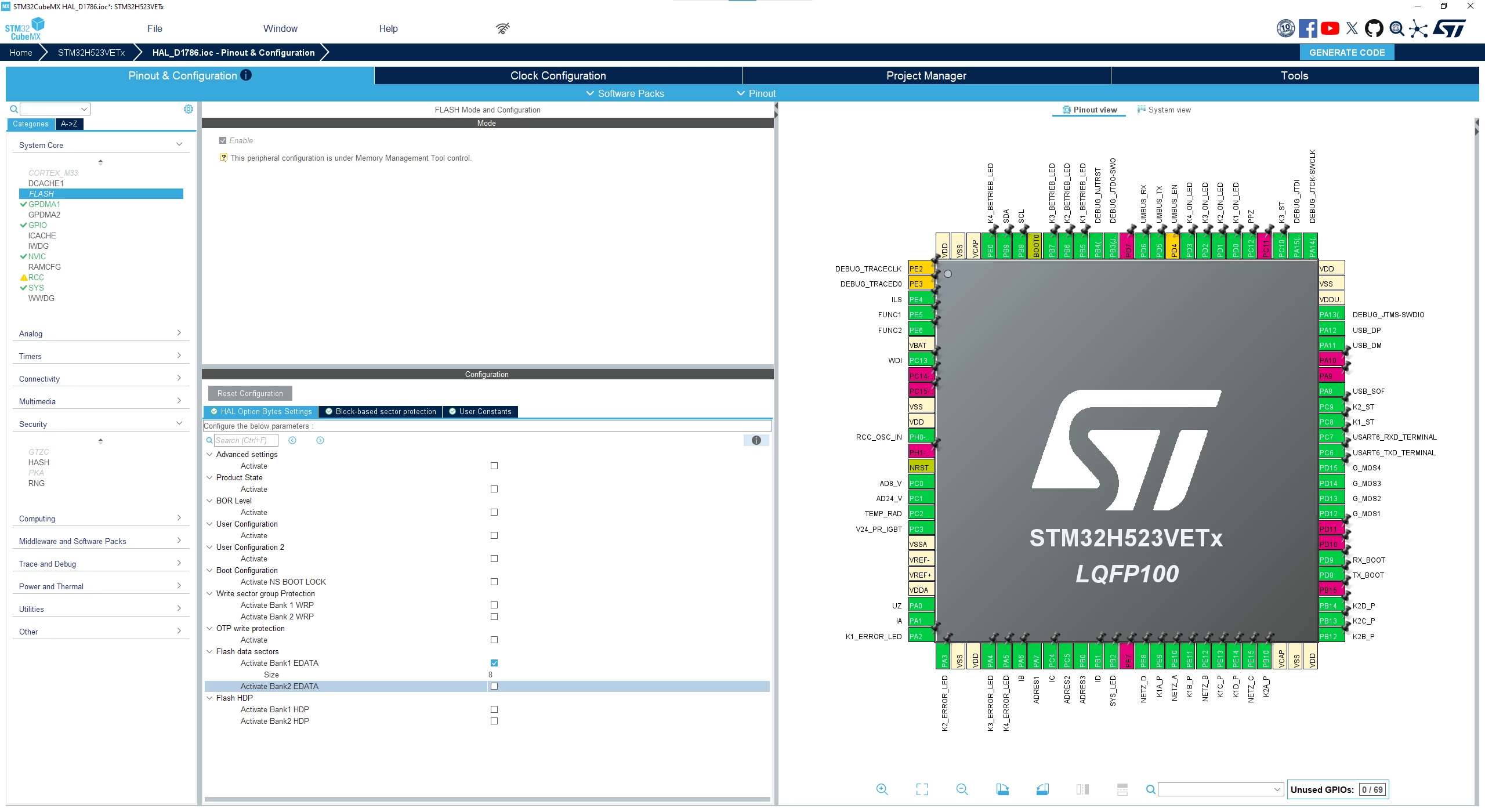

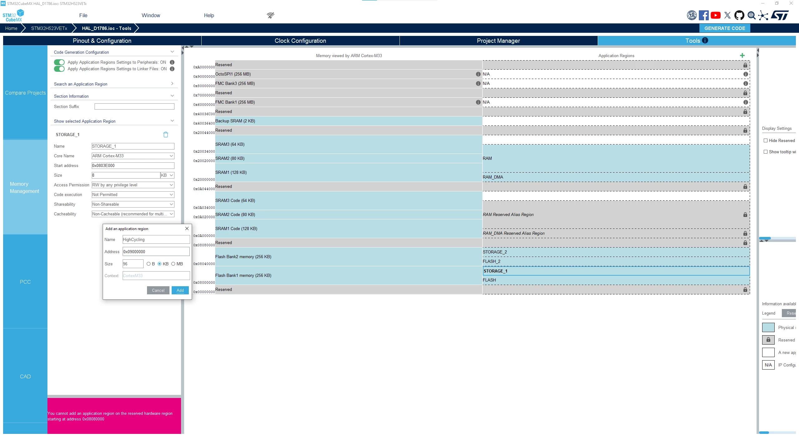

I've same problem with STM32H523VET:
- Windows 10,
- STM32CubeMX 6.17.0,
- STM32CubeH5 v 1.6.0
Ghofrane GSOURI
Apr 27, 2026 3:35 PM UTC
Hello @Rudy_ini
Thank you for your contribution.

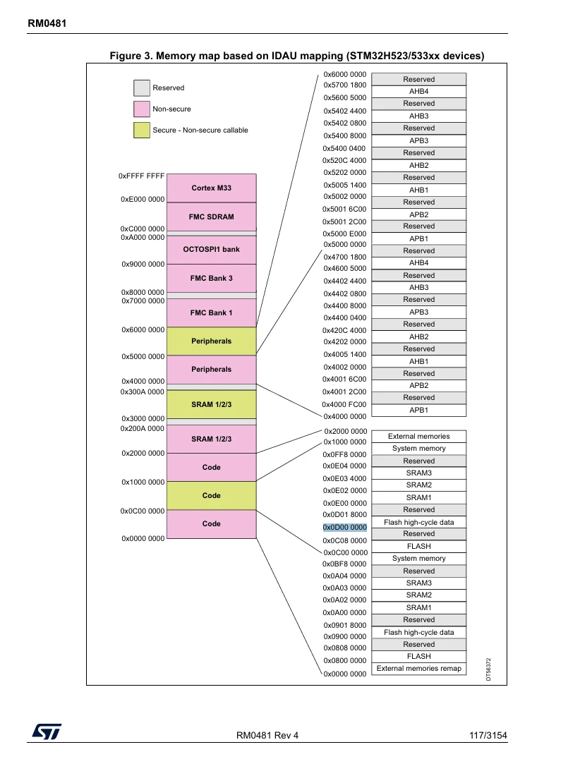

User should be able to add a memory region at 0x0D000000 in Memory Management
based on RM0481 Rev 3 :Figure 3. Memory map based on IDAU mapping (STM32H523/533xx devices)
Flash high-cycle data : is mapped to the address 0x0D00_0000 to 0x0D01 8000
A ticket #0062278 has been escalated to dev team to correct this behavior.

Ghofrane GSOURI
Jul 1, 2026 8:46 AM UTC
Hello ​@Rudy_ini
This issue has been fixed in the latest version of STM32CubeMX 6.18.0
Download STM32CubeMX6.18.0 from  here
THX
