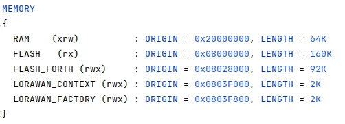

September 12, 2023
So, I am setting up linker script as @Andrew Larkin suggested and going to use an external tool to populate the Flash.
MEMORY
    RAM (xrw) : ORIGIN = 0x20000000, LENGTH = 64K
    FLASH (rx) : ORIGIN = 0x08000000, LENGTH = 160K
    FLASH_FORTH (rwx) : ORIGIN = 0x08028000, LENGTH = 92K
    FLASH_NVM (rwx) : ORIGIN = 0x0803F000, LENGTH = 2K
    LORAWAN_CONTEXT (rwx) : ORIGIN = 0x0803F800, LENGTH = 2K
.embeddedKeys :
    *(.USER_embedded_Keys)
    LORAWAN_NVM_BASE_ADDRESS = .;
    FILL(0xFFFFFFFF);
    . = ORIGIN(LORAWAN_CONTEXT) + LENGTH(LORAWAN_CONTEXT) - 1;
    BYTE(0xFF)
} >LORAWAN_CONTEXT
That also takes care of the LORAWAN_NVM_BASE_ADDRESS to be from linker script rather than buried in lora-app.c.

September 15, 2023
Nice overview! And yes, I have defined 0x0803f000 and 0x0803f800 as two regions in the linker script, and removed the seNvmInit declaration i soft-se.c, and removed LORAWAN_NVM_BASE_ADDRESS and introduced LORAWAN_NVM_CONTEXT, which (with the definitions below) is a variable (declared as an array will get the address when used).
extern uint8_t LORAWAN_NVM_CONTEXT[2048];
But I now have a system I can't use CubeMX on, as it will reset some of the changes I made. But, the way RAKwireless "low level development" (I use RAK3172) provides a driver is to overwrite the radio(-if) files, which are also re-generated by CubeMX. So the whole point of using ST supported LoraWAN is negated to a large degree right now. :\
@Andrew Larkin Thanks a lot. Without your engagement, I would probably have reverted to an STM32L1 + SX1276 and the Semtech stack. I hope ST can improve the integration, even if compatibility can't be maintained.

I have implemented a version of your fix for the context that I think you will like...
In lora_app.c:
/* LoRaWAN NVM configuration */
* @brief LoRaWAN NVM Flash address
* @note last 2 sector of a 128kBytes device
#define LORAWAN_NVM_BASE_ADDRESS ((void *)0x0803F000UL)
/* USER CODE BEGIN PD */
#undef LORAWAN_NVM_BASE_ADDRESS
extern uint8_t LORAWAN_NVM_BASE_ADDRESS[4096];
/* USER CODE END PD */
This solves the regeneration issue.
On the second point of the factory settings, the code already tags the seNvmInit with the USER_embedded_Keys segment, so I think the cleaner way to handle this is to locate the segment where you need it.
This solution also remains "clean" to code regeneration.
I chose a different memory arrangement in the ld linker script as follows:
/* Memories definition */
MEMORY
RAM2 (xrw) : ORIGIN = 0x10000000, LENGTH = 32K
FLASH (rx) : ORIGIN = 0x08000000, LENGTH = 250K
LORAWAN_FACTORY (rx) : ORIGIN = 0x0803E800, LENGTH = 2K
LORAWAN_CONTEXT (rx) : ORIGIN = 0x0803F000, LENGTH = 4K
/* USER Embedded Keys data into "FACTORY" Rom type memory */
.embeddedKeys :
. = ALIGN(4);
. = ALIGN(4);
} >LORAWAN_FACTORY
.context :
} >LORAWAN_CONTEXT
I know you were trying to avoid unneeded the use of an extra 2k page, but I wanted to keep the memory structure the same for two reasons:
1. There is a good chance I will be using the fragmented data block support and I definitely didn't want it to be overwriting the seNvmInit data!
2. Support for KMS looks like it does require both pages of memory, if I ever want to turn this on as well.
I think both issues will come into effect if I start playing with FUOTA which I very much want to have running.
I note you were tagging the additional memory areas with (rwx). I don't know if it works to close a door to attack or not, but I choose to leave off the "x" is this memory shouldn't be executing code.
For details of how I generated the "clean" project for the RAK3172, see https://github.com/danak6jq/RAK3172/issues/12#issuecomment-1704666372
