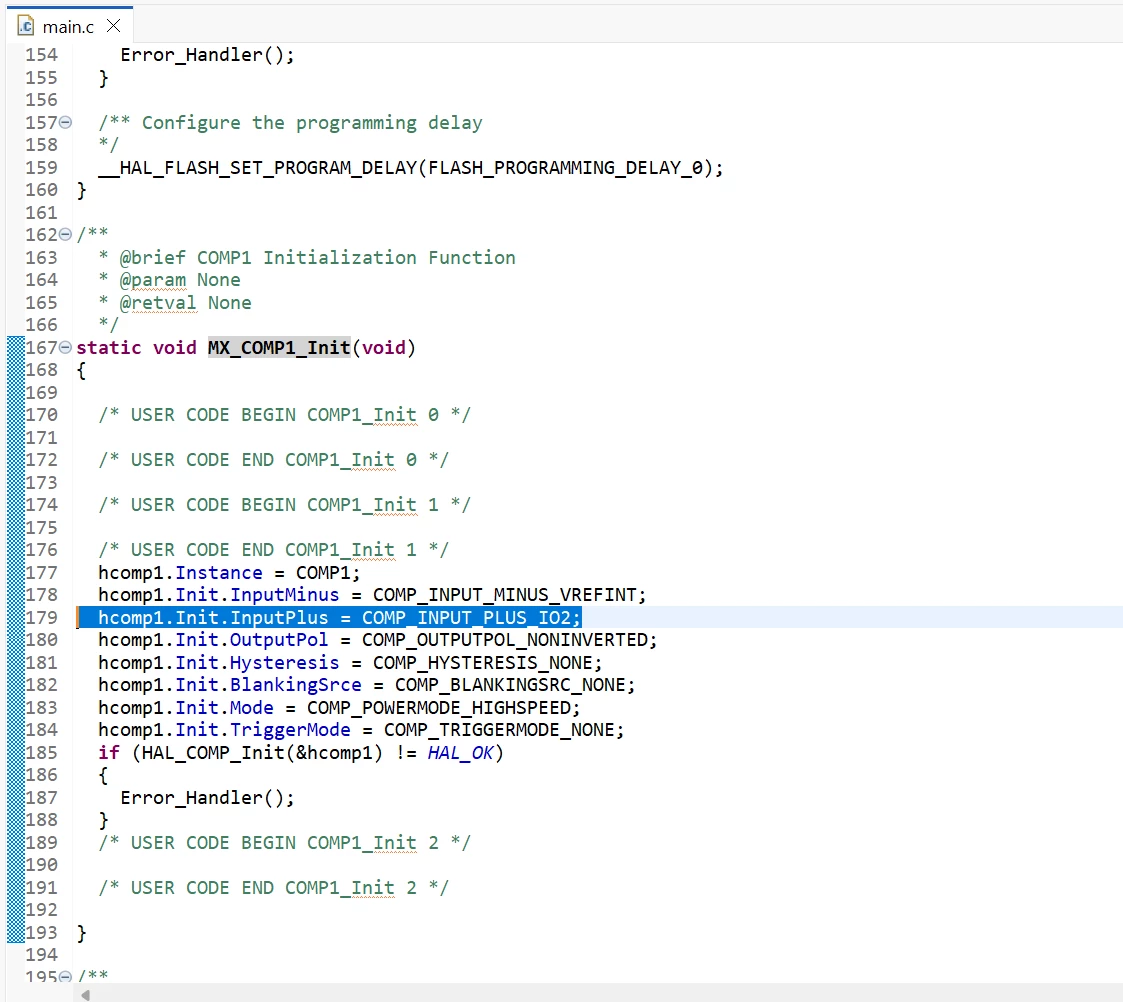

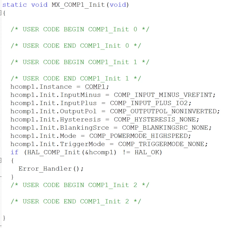

Hello ​@bhushan_pawar
I have performed a test using the latest version of STM32CubeMX6.18.1 and the generated code is correct . Please check the screenshots
I will be waiting for your feedback.
THX
Ghofrane

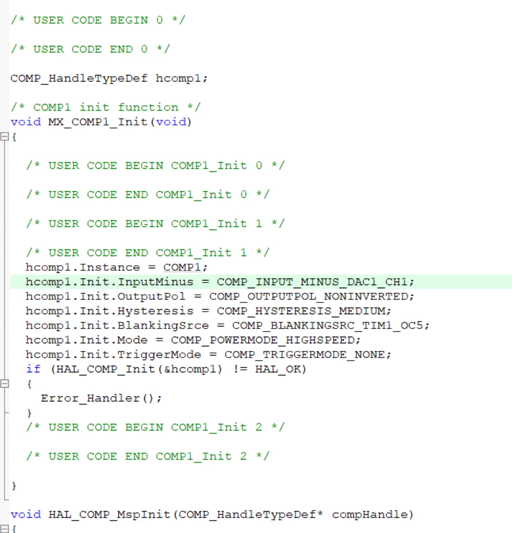

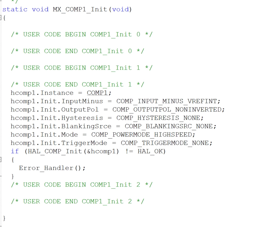

Oct 15, 2026 8:30 AM UTC
Thanks sir… for your reply , but when i generated for MDK-ARM and found..
I verified once again … but the error remains same… My comparator INP is at PB2

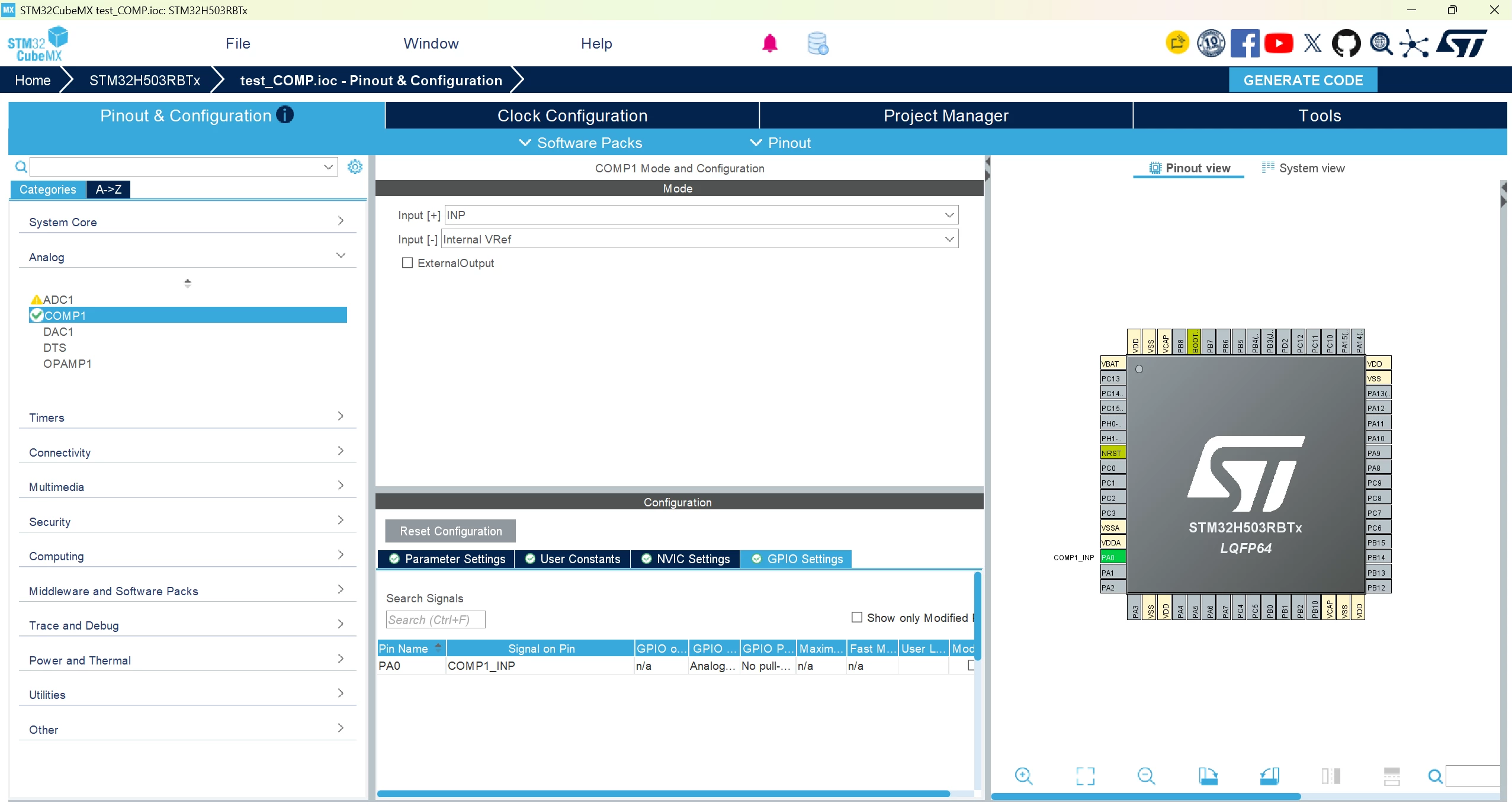

Oct 15, 2026 8:38 AM UTC
I verified with your provided test_COMP.ioc.. and the result remains same..
But for PA0 it generates…
