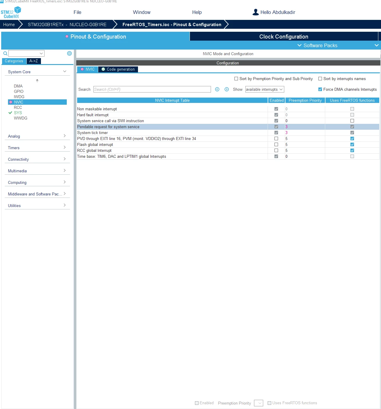

CubeMX issue in regard to Preemption Priority (FreeRTOS example)
CubeMX Version : 6.10.0
Steps to reproduce :
  • Create new project
  • Example selector
  • Board : NUCLEO-G0B1RE
  • Middleware : FreeRTOS selected
  • There are 3 Examples : select "FreeRTOS_Timers" or "FreeRTOS_Semaphore" and Start-Project
  • Select open with "CubeMX" and see the Pinout & configuration -> NVIC red-icon, klick on NVIC
    the priority cannot be changed (everything deactivated)
