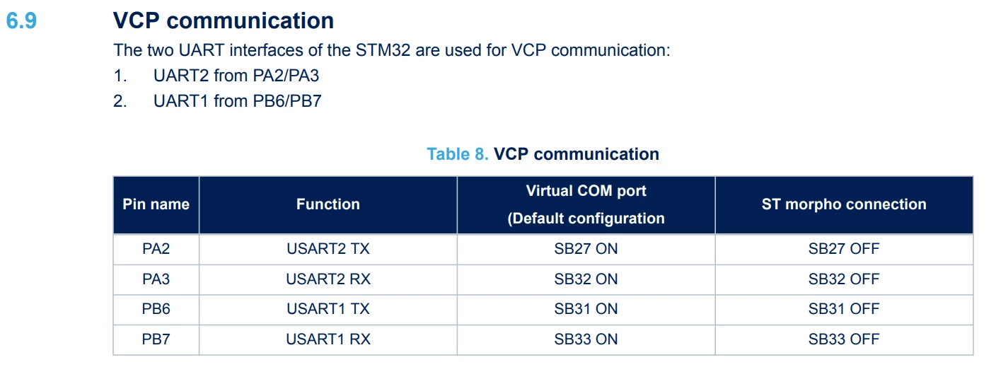

CubeMX initializes USART1 peripheral on NUCLEO-C031C6 by default.
But USART2 is actually connected to ST-LINK VCP wire.

Hello @_0x4d​ ,
I confirmed the issue and I reported it internally in order to fix it.
Internal ticket number: 145172 (This is an internal tracking number and is not accessible or usable by customers).
