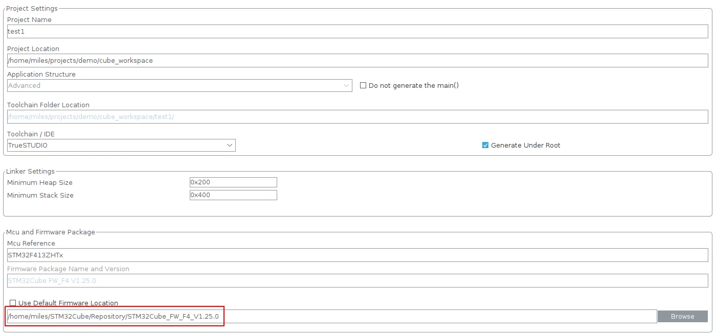

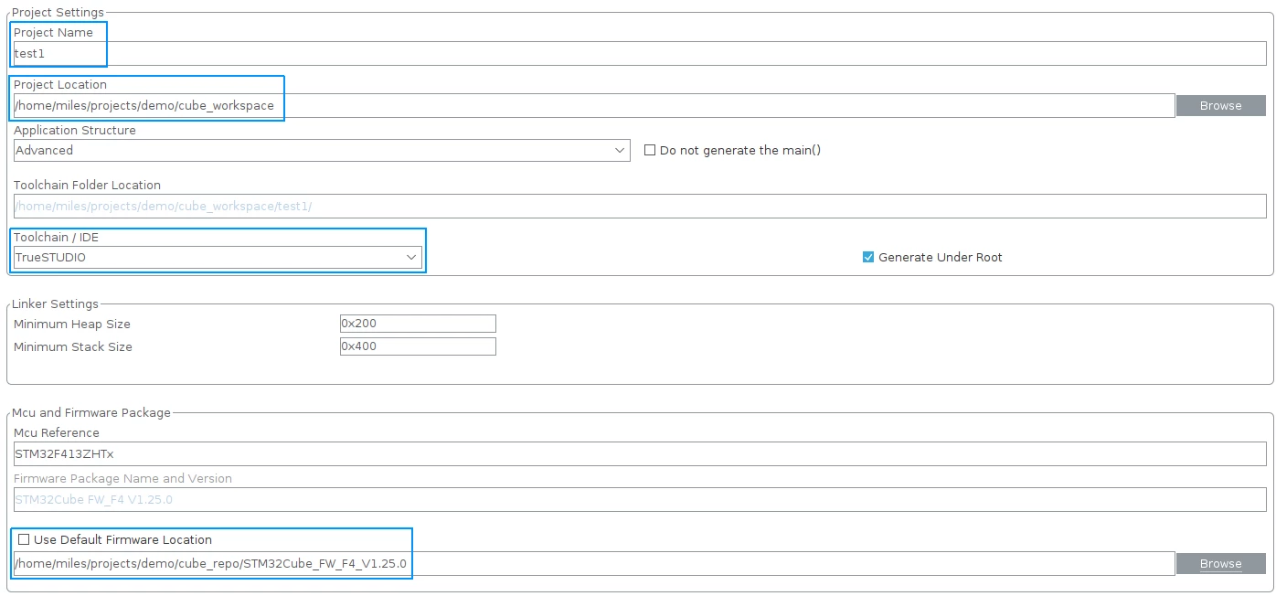

  • Project Manager > Project > Firmware Location (custom path reset back to default path)

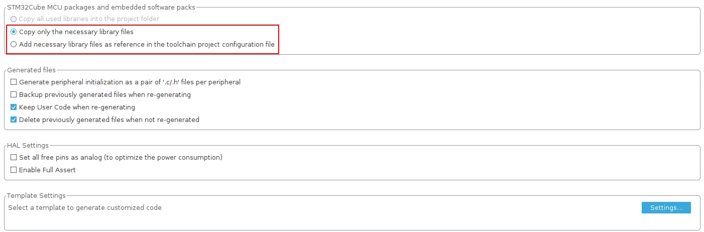

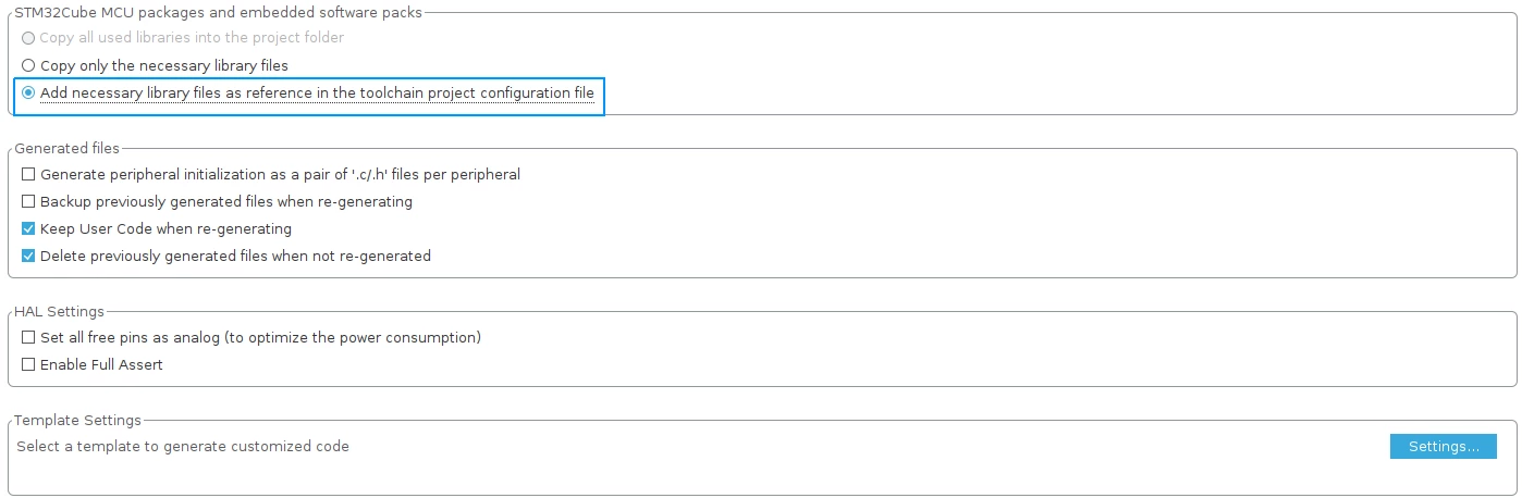

  • Project Manager > Project > Add library files as reference (reset back to copy)

  • Launch CubeMX, and create a new project with the following settings:

  • Reopen CubeMX and the previous project, note that the following settings have been reset:
