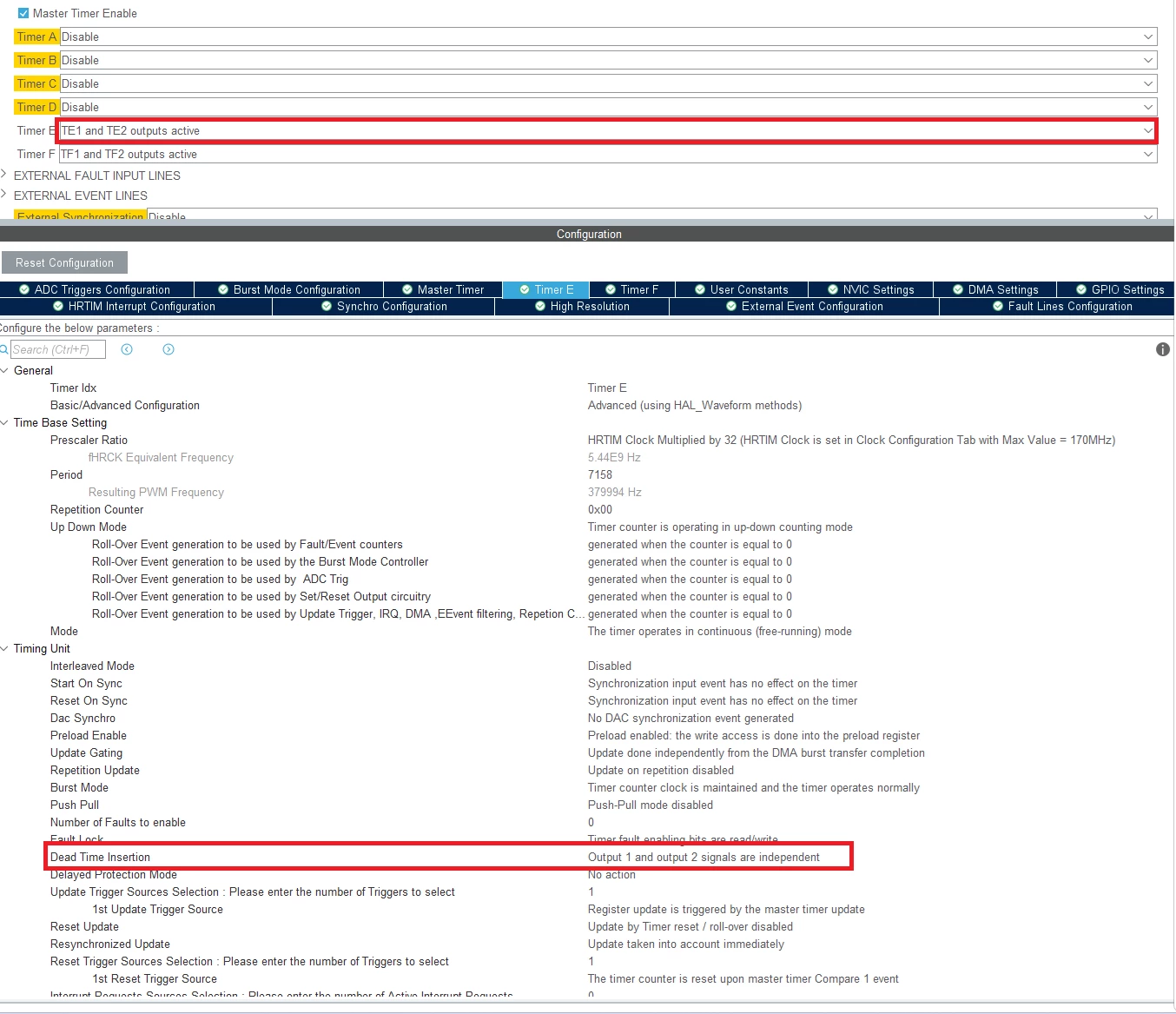

CubeMX HRTIM cannot set set sources with deadtime disabled

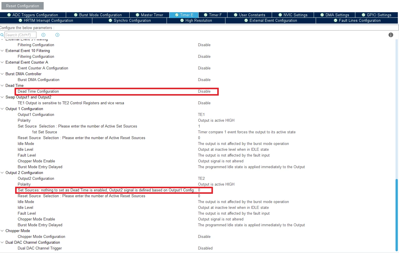

the cubemx HRTIM configuration will not let me set the set sources for Output 2, even though deadtime insertion is turned off.
I had previously enabled it, and now disabled it. Since then I am unable to add a set source for Output 2.
See the attached screenshots and .ioc file.
I am using version 6.17.0

This issue has been already reported to the dedicated team (Internal Ticket Number: CDM0063357).
I will let you know as soon as the issue is solved.
