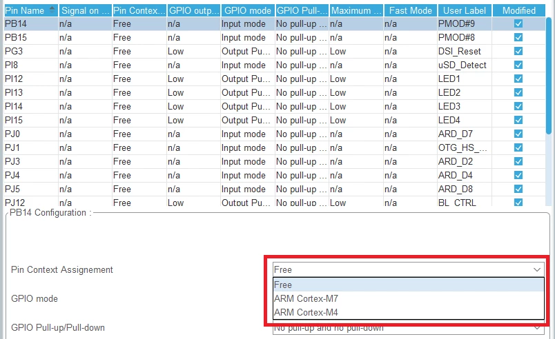

Sorry, I did not explore fully the GPIO in CubeMX for dual core like the H747.
You may need to assign which core will need to init it.

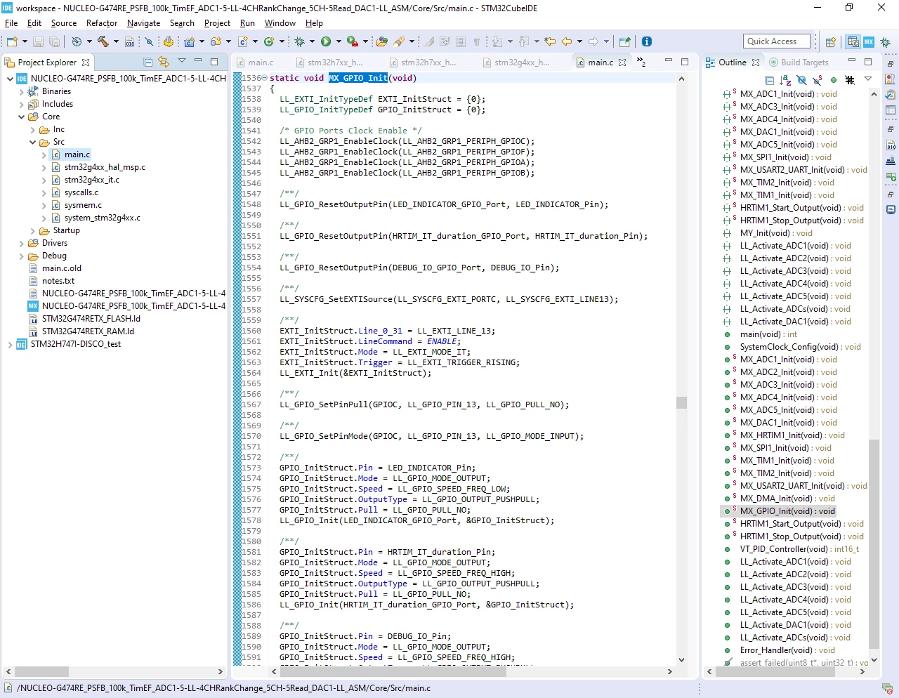

> GPIO initialization for various peripherals is generally within the HAL_*_MspInit functions which are placed in "stm32h7xx_hal_mspinit.c". The code you've linked just enables the clocks (and MCO).
Generally the GPIO init is in main.c from my previous projects as shown below.
The "stm32h7xx_hal_msp.c" does not contain GPIO init.

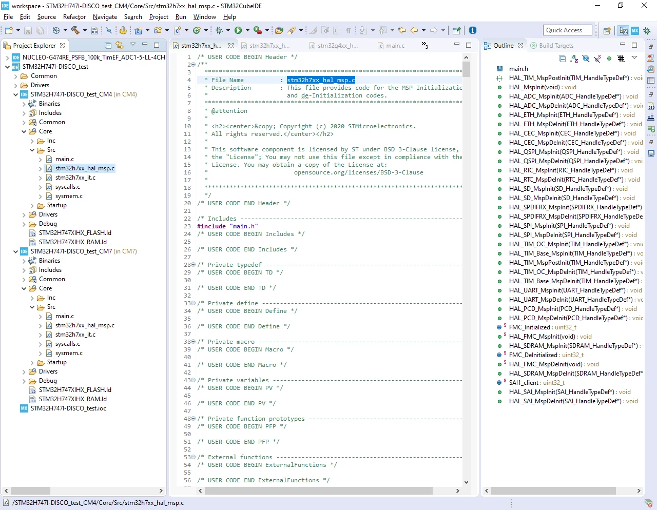

Also you may notice that stm32h7xx_hal_msp.c and stm32h7xx_it.c is under M4 folder as shown below. Must be typo during code generation.
 BTW, this is the code/project generated where the pins are initialized as default.
Why would that be a typo? Both files are present in both of the cores, although their contents will not be identical.
