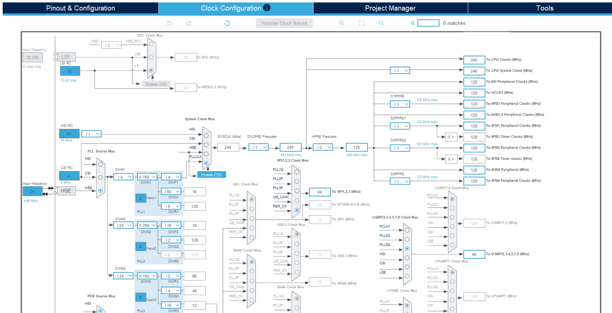

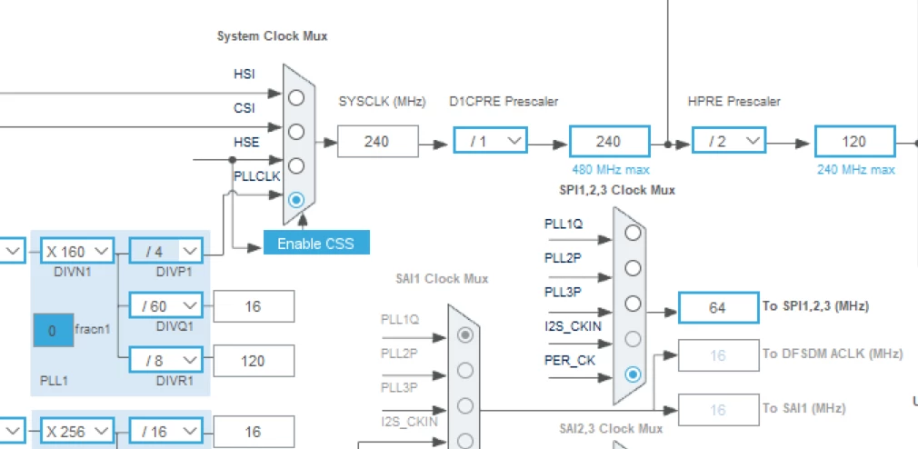

I have already tried changing the PLL and clock parameters in the Clock Configuration tab of CubeMX and then restoring the original values, to check whether CubeMX was not correctly updating the clock tree calculation, but the generated code still contains FLASH_LATENCY_0.

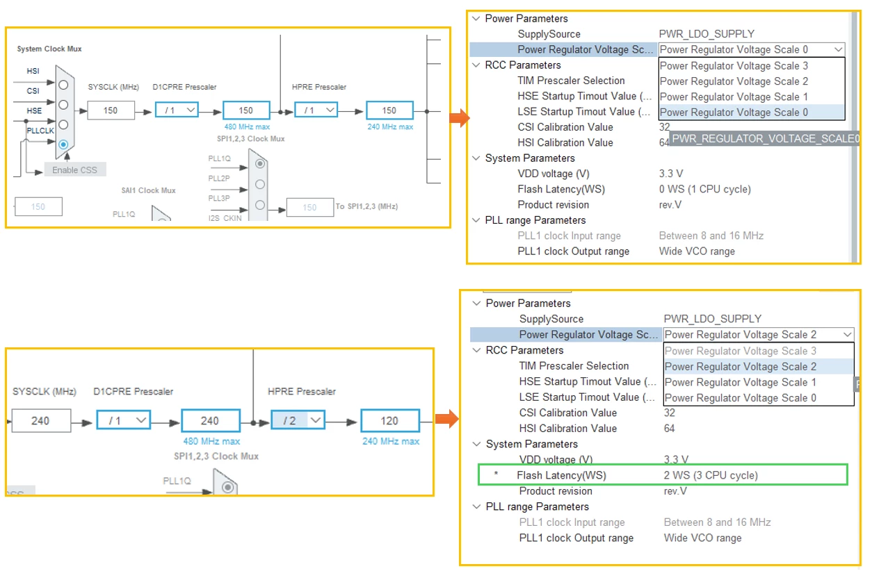

Jul 13, 2026 2:35 PM UTC
Hello ​@ARagn.1
As a workaround, can you please follow the steps below to help CubeMX recompute and apply the proper FLASH latency setting:
  1. Open the Clock Configuration tab in CubeMX.
  2. Temporarily decrease SYSCLK value for example 150 MHz.
  3. Go to the RCC configuration settings.
  4. Set Power Regulator Voltage SCALE to Scale 0.
  5. Return to Clock Configuration.
  6. Restore your intended clock values, for example:240 MHz/120 MHz
  7. Go back again to the RCC configuration.
  8. Change Power Regulator Voltage SCALE to Scale 2.
CubeMX now should refresh the flash wait-state computation, and the FLASH Latency should now be shown as 2WS, which results in the correct generated FLASH_LATENCY_2
BR, Souhaib

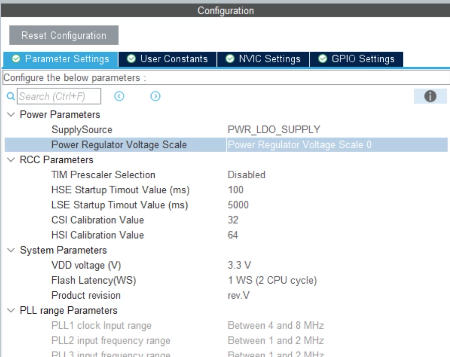

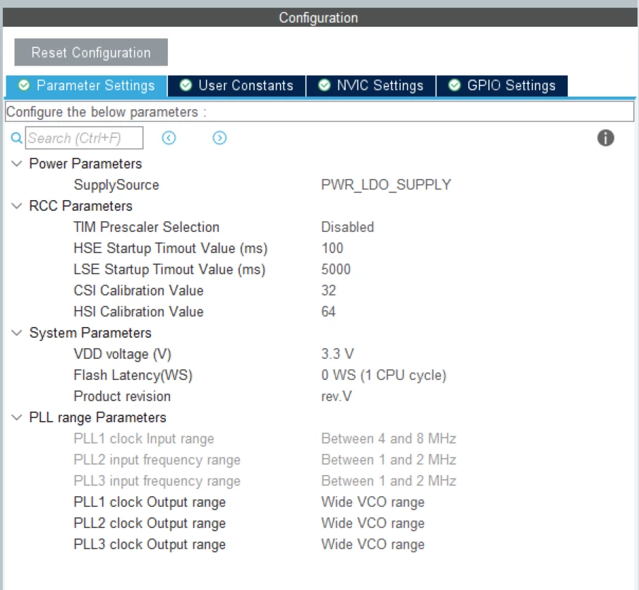

ARagn.1
ARagn.1Author
Jul 17, 2026 2:24 PM UTC
 Hello ​@Souhaib MAZHOUD,
Thanks for your help, I followed your procedure but when I restore 240MHz I don’t see anymore the section: “Power Regulator Voltage Scale”.
Please let me know if there is anything else I can do.
Andrea

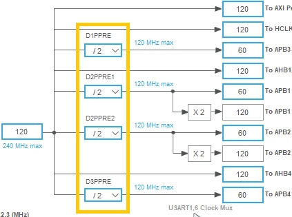

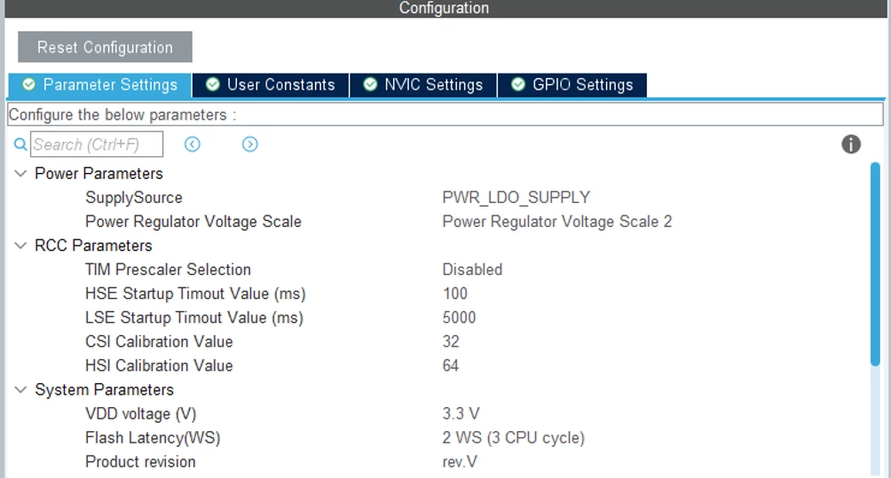

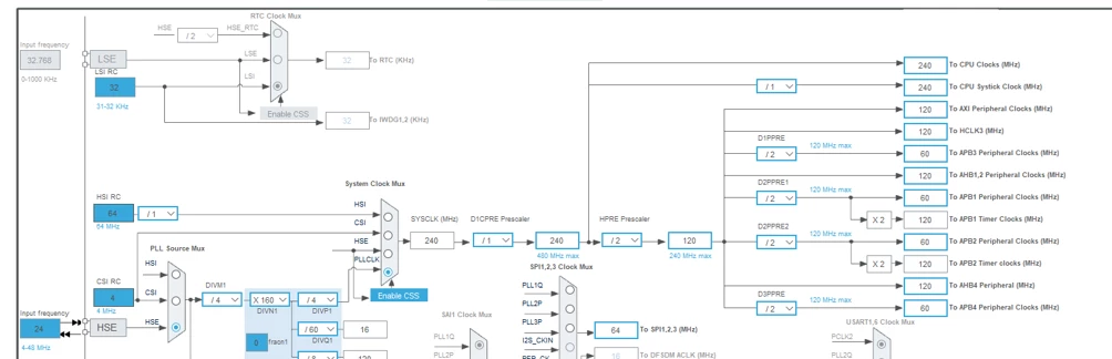

Jul 17, 2026 5:21 PM UTC
Hello ​@ARagn.1
Can you try to set all APB prescalers to /2 instead of /1 as below and check please?
To give better visibility on the answered topics, please click on 'Best answer' on the reply which solved your issue or answered your question.

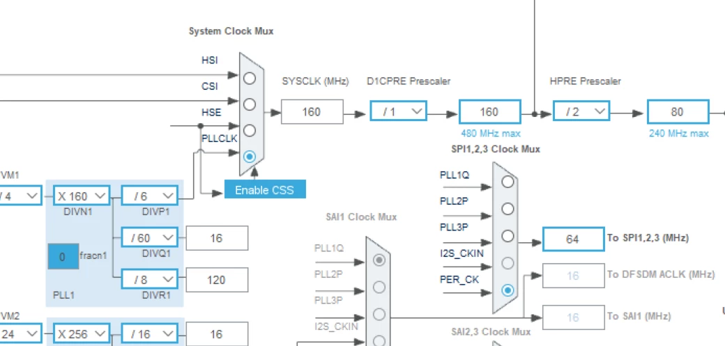

ARagn.1
ARagn.1Author
Jul 20, 2026 3:33 PM UTC
 Hi ​@Souhaib MAZHOUD,
if I change APB prescalers from /1 to /2 I get this:
However if I go back to /1 I get again FLASH_LATENCY_0
Do you have any other idea?
Thanks,
Andrea
