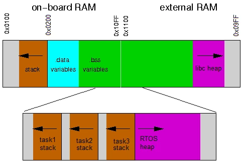

CubeMX generated _sbrk() syscall does not work with freeRTOS enabled. Is there a recommended _sbrk that work well with freeRTOS? And if so, what is it and could you include it into CubeMX that is enabled only if freeRTOS is activated.

I was trying to do a basic cubemx generated project with freeRTOS and libc standard lib enabled. While blinking led went without issue... as soon as I called `putchar()` or `printf()`, _sbrk() said there was a stack collision with the heap.
Inspecting the position of the stack pointer relative to the heap pointer... the stack pointer is behind the heap pointer. But the stackpointer can be behind the libc heap, as the stackpointer would be pointing to the freeRTOS's task stack pointer instead for each task.
My stopgap solution is to ignore the check (at my own risk) for now for a practice project.

I tried to modify the check to use `extern char end asm("_estack")` to check between the heap pointer and the roof of the memory. But was unable to, since I'm still learning about how to get linker symbols to be accessible like how you did with the `end` linker symbol.
This is based on my understanding of how freertos memory works according to http://amichalec.net/2014/05/24/water-level-logger-external-ram/ (Specifically this diagram http://amichalec.net/wp-content/uploads/2014/05/malloc-custom.png)

@Brian Khuu​ - You might find this helpful (to be updated in next couple weeks for current STM tools)...
http://www.nadler.com/embedded/newlibAndFreeRTOS.html

@Brian Khuu​ - I just updated the document and included the set of required fixes for ST32F..
Any feedback will be greatly appreciated (especially if I wasn't clear)!
