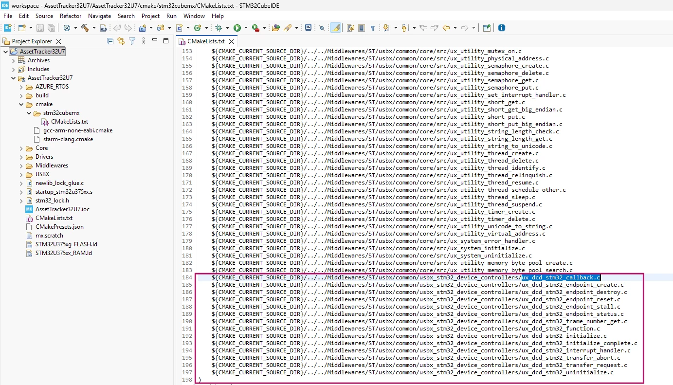

CubeMX forgets to include "usbx_stm32_device_controllers" sources in cmake
STM32CubeMX version 6.18.0.
When generating “cmake/stm32cubemx/CMakeLists.txt” does not include source files from directory “Middlewares/ST/usbx/common/usbx_stm32_device_controllers”. My workaround is to add those sources in project CMakeLists.txt:
# Set usbx_stm32_device_controllers code files
set(USBD_STM32_DEVICE_CONTROLLERS_DIR ${CMAKE_CURRENT_SOURCE_DIR}/Middlewares/ST/usbx/common/usbx_stm32_device_controllers)
set(USBD_STM32_DEVICE_CONTROLLERS_SRCS
${USBD_STM32_DEVICE_CONTROLLERS_DIR}/ux_dcd_stm32_callback.c
${USBD_STM32_DEVICE_CONTROLLERS_DIR}/ux_dcd_stm32_endpoint_create.c
${USBD_STM32_DEVICE_CONTROLLERS_DIR}/ux_dcd_stm32_endpoint_destroy.c
${USBD_STM32_DEVICE_CONTROLLERS_DIR}/ux_dcd_stm32_endpoint_reset.c
${USBD_STM32_DEVICE_CONTROLLERS_DIR}/ux_dcd_stm32_endpoint_stall.c
${USBD_STM32_DEVICE_CONTROLLERS_DIR}/ux_dcd_stm32_endpoint_status.c
${USBD_STM32_DEVICE_CONTROLLERS_DIR}/ux_dcd_stm32_frame_number_get.c
${USBD_STM32_DEVICE_CONTROLLERS_DIR}/ux_dcd_stm32_function.c
${USBD_STM32_DEVICE_CONTROLLERS_DIR}/ux_dcd_stm32_initialize_complete.c
${USBD_STM32_DEVICE_CONTROLLERS_DIR}/ux_dcd_stm32_initialize.c
${USBD_STM32_DEVICE_CONTROLLERS_DIR}/ux_dcd_stm32_interrupt_handler.c
${USBD_STM32_DEVICE_CONTROLLERS_DIR}/ux_dcd_stm32_transfer_abort.c
${USBD_STM32_DEVICE_CONTROLLERS_DIR}/ux_dcd_stm32_transfer_request.c
${USBD_STM32_DEVICE_CONTROLLERS_DIR}/ux_dcd_stm32_transfer_run.c
${USBD_STM32_DEVICE_CONTROLLERS_DIR}/ux_dcd_stm32_uninitialize.c
# Add sources to executable
target_sources(${CMAKE_PROJECT_NAME} PRIVATE
${USBD_STM32_DEVICE_CONTROLLERS_SRCS}
# Add user sources here

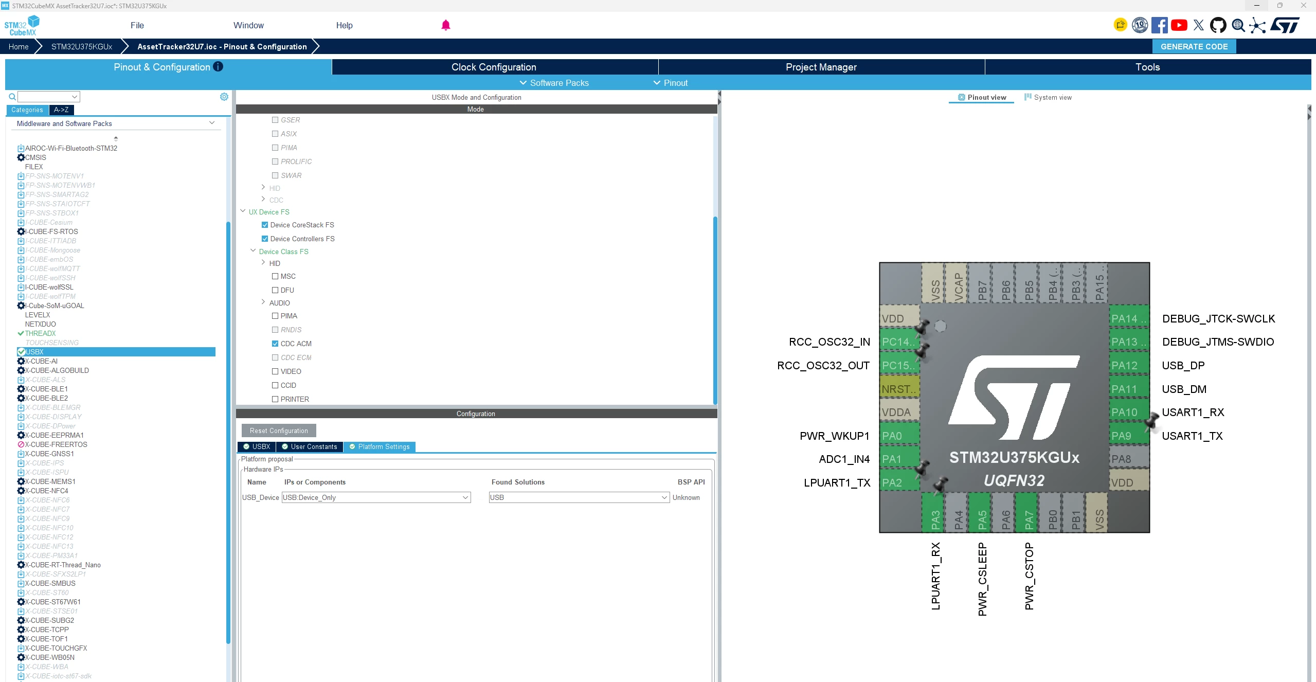

Hello ​@MZina.1
Further to your comment, you need to enable the Device Controllers FS under USBX ; UX Device FS.
I will be waiting for your feedback.

PCC.Seq0.Step3.Category=In DS Table
PCC.Seq0.Step3.DMIPS=0.0
PCC.Seq0.Step3.Duration=0.9 ms
PCC.Seq0.Step3.Frequency=0 Hz
PCC.Seq0.Step3.Memory=FLASH
PCC.Seq0.Step3.Mode=STANDBY
PCC.Seq0.Step3.Oscillator=ALL_CLOCKS_OFF
PCC.Seq0.Step3.Peripherals=
PCC.Seq0.Step3.TaMax=110
PCC.Seq0.Step3.User's_Consumption=0 mA
PCC.Seq0.Step3.Vcore=NA
PCC.Seq0.Step3.Vdd=3.0
PCC.Seq0.Step3.Voltage_Source=Battery
PCC.SequenceTime=1.0 ms
PCC.SequenceTime.Unit=ms
PCC.Series=STM32U3
PCC.Temperature=25
PCC.Vdd=3.0
PinOutPanel.RotationAngle=0
ProjectManager.AskForMigrate=true
ProjectManager.BackupPrevious=false
ProjectManager.CompilerLinker=GCC
ProjectManager.CompilerOptimize=6
ProjectManager.ComputerToolchain=false
ProjectManager.CoupleFile=true
ProjectManager.CustomerFirmwarePackage=
ProjectManager.DefaultFWLocation=true
ProjectManager.DeletePrevious=true
ProjectManager.DeviceId=STM32U375KGUx
ProjectManager.FirmwarePackage=STM32Cube FW_U3 V1.4.0
ProjectManager.FreePins=true
ProjectManager.FreePinsContext=
ProjectManager.HalAssertFull=true
ProjectManager.HeapSize=0x200
ProjectManager.KeepUserCode=true
ProjectManager.LastFirmware=true
ProjectManager.LibraryCopy=1
ProjectManager.MainLocation=Core/Src
ProjectManager.MultiThreaded=true
ProjectManager.NoMain=false
ProjectManager.PreviousToolchain=
ProjectManager.ProjectBuild=false
ProjectManager.ProjectFileName=AssetTracker32U7.ioc
ProjectManager.ProjectName=AssetTracker32U7
ProjectManager.ProjectStructure=
ProjectManager.RegisterCallBack=
ProjectManager.StackSize=0x400
ProjectManager.TargetToolchain=CMake
ProjectManager.ThreadSafeStrategy=CortexM33\:Default,
ProjectManager.ToolChainLocation=
ProjectManager.UAScriptAfterPath=
ProjectManager.UAScriptBeforePath=
ProjectManager.UnderRoot=false
ProjectManager.functionlistsort=1-SystemClock_Config-RCC-false-HAL-false,2-MX_GPIO_Init-GPIO-false-HAL-true,3-MX_RTC_Init-RTC-false-HAL-true,4-MX_USART1_UART_Init-USART1-false-HAL-true,5-MX_USB_PCD_Init-USB-false-HAL-true,6-MX_ICACHE_Init-ICACHE-false-HAL-true,7-MX_USBX_Init-USBX-true-HAL-false,8-MX_LPUART1_UART_Init-LPUART1-false-HAL-true,9-MX_ADC1_Init-ADC1-false-HAL-true,0-MX_CORTEX_M33_NS_Init-CORTEX_M33_NS-false-HAL-true,0-MX_PWR_Init-PWR-false-HAL-true
RCC.ADCFreq_Value=96000000
RCC.ADF1Freq_Value=96000000
RCC.AHBFreq_Value=96000000
RCC.APB1Freq_Value=96000000
RCC.APB1TimFreq_Value=96000000
RCC.APB2Freq_Value=96000000
RCC.APB2TimFreq_Value=96000000
RCC.APB3Freq_Value=96000000
RCC.CRSFreq_Value=48000000
RCC.CortexFreq_Value=12000000
RCC.DACFreq_Value=32000
RCC.FCLKCortexFreq_Value=96000000
RCC.FDCANFreq_Value=96000000
RCC.FamilyName=M
RCC.HCLKFreq_Value=96000000
RCC.HSE_VALUE=16000000
RCC.HSI48_VALUE=48000000
RCC.HSI_VALUE=16000000
RCC.I2C1Freq_Value=96000000
RCC.I2C3Freq_Value=96000000
RCC.I3C1Freq_Value=96000000
RCC.I3C2Freq_Value=96000000
RCC.IPParameters=ADCFreq_Value,ADF1Freq_Value,AHBFreq_Value,APB1Freq_Value,APB1TimFreq_Value,APB2Freq_Value,APB2TimFreq_Value,APB3Freq_Value,CRSFreq_Value,CortexFreq_Value,DACFreq_Value,FCLKCortexFreq_Value,FDCANFreq_Value,FamilyName,HCLKFreq_Value,HSE_VALUE,HSI48_VALUE,HSI_VALUE,I2C1Freq_Value,I2C3Freq_Value,I3C1Freq_Value,I3C2Freq_Value,LPTIM1Freq_Value,LPTIM2Freq_Value,LPTIM3Freq_Value,LPUART1Freq_Value,LSCOPinFreq_Value,LSIDIV_VALUE,LSI_VALUE,MCO1PinFreq_Value,MCO2PinFreq_Value,MSISDIV,MSISFreq_Value,OCTOSPIMFreq_Value,RNGFreq_Value,RTCClockSelection,RTCFreq_Value,SAI1Freq_Value,SPI1Freq_Value,SPI3Freq_Value,SYSCLKFreq_VALUE,SupplySource,UART4Freq_Value,USART1Freq_Value,USART3Freq_Value,USBFreq_Value,USB_DIV,VDD_VALUE
RCC.LPTIM1Freq_Value=96000000
RCC.LPTIM2Freq_Value=96000000
RCC.LPTIM3Freq_Value=96000000
RCC.LPUART1Freq_Value=96000000
RCC.LSCOPinFreq_Value=32000
RCC.LSIDIV_VALUE=32000
RCC.LSI_VALUE=32000
RCC.MCO1PinFreq_Value=96000000
RCC.MCO2PinFreq_Value=96000000
RCC.MSISDIV=RCC_MSI_DIV1
RCC.MSISFreq_Value=96000000
RCC.OCTOSPIMFreq_Value=96000000
RCC.RNGFreq_Value=48000000
RCC.RTCClockSelection=RCC_RTCCLKSOURCE_LSE
RCC.RTCFreq_Value=32768
RCC.SAI1Freq_Value=96000000
RCC.SPI1Freq_Value=96000000
RCC.SPI3Freq_Value=96000000
RCC.SYSCLKFreq_VALUE=96000000
RCC.SupplySource=PWR_LDO_SUPPLY
RCC.UART4Freq_Value=96000000
RCC.USART1Freq_Value=96000000
RCC.USART3Freq_Value=96000000
RCC.USBFreq_Value=48000000
RCC.USB_DIV=RCC_USB1CLKSOURCE_ICLK_DIV2
RCC.VDD_VALUE=2.5
RTC.Alarm=RTC_ALARM_A
RTC.IPParameters=Alarm
STMicroelectronics.X-CUBE-FREERTOS.1.5.0_SwParameter=RTOS2CcCMSISJjRTOS2JjHeap\:HeapIi4;RTOS2CcCMSISJjRTOS2JjCore\:TZIiNonIiSupported;
THREADX.AZRTOS_APP_MEM_ALLOCATION_METHOD=1
THREADX.IPParameters=TX_REACTIVATE_INLINE,TX_TIMER_PROCESS_IN_ISR,TX_NO_FILEX_POINTER,TX_APP_GENERATE_INIT_CODE,TX_APP_CREATION,TX_APP_SEM_CREATION,TX_APP_MSG_QUEUE_CREATION,TX_APP_MEM_POOL_SIZE,AZRTOS_APP_MEM_ALLOCATION_METHOD
THREADX.TX_APP_CREATION=1
THREADX.TX_APP_GENERATE_INIT_CODE=true
THREADX.TX_APP_MEM_POOL_SIZE=65535
THREADX.TX_APP_MSG_QUEUE_CREATION=1
THREADX.TX_APP_SEM_CREATION=1
THREADX.TX_NO_FILEX_POINTER=1
THREADX.TX_REACTIVATE_INLINE=1
THREADX.TX_TIMER_PROCESS_IN_ISR=1
USART1.IPParameters=VirtualMode-Asynchronous
USART1.VirtualMode-Asynchronous=VM_ASYNC
USB.IPParameters=VirtualMode,iso_singlebuffer_enable,bulk_doublebuffer_enable,Sof_enable-Device
USB.Sof_enable-Device=ENABLE
USB.VirtualMode=Device_Only
USB.bulk_doublebuffer_enable=ENABLE
USB.iso_singlebuffer_enable=ENABLE
USBX.Core_System=1
USBX.IPParameters=Core_System,UX_Device_CoreStack,UX_DEVICE_CDC_ACM,USBD_CDCACM_EPIN_ADDR,USBD_CDCACM_EPOUT_ADDR,UX_DEVICE_APP_MEM_POOL_SIZE,REG_UX_DEVICE_CORE,USBX_DEVICE_SYS_SIZE,USBX_DEVICE_APP_THREAD_Size,UX_APP_MEM_POOL_SIZE,USBX_SYS_SIZE,UX_MAX_SLAVE_INTERFACES,UX_MAX_DEVICE_INTERFACES,UX_MAX_DEVICE_ENDPOINTS
USBX.REG_UX_DEVICE_CORE=true
USBX.USBD_CDCACM_EPIN_ADDR=2
USBX.USBD_CDCACM_EPOUT_ADDR=3
USBX.USBX_DEVICE_APP_THREAD_Size=4098
USBX.USBX_DEVICE_SYS_SIZE=16389
USBX.USBX_SYS_SIZE=8192
USBX.UX_APP_MEM_POOL_SIZE=16385
USBX.UX_DEVICE_APP_MEM_POOL_SIZE=32768
USBX.UX_DEVICE_CDC_ACM=1
USBX.UX_Device_CoreStack=1
USBX.UX_MAX_DEVICE_ENDPOINTS=3
USBX.UX_MAX_DEVICE_INTERFACES=1
USBX.UX_MAX_SLAVE_INTERFACES=2
VP_CORTEX_M33_NS_VS_Hclk.Mode=Hclk_Mode
VP_CORTEX_M33_NS_VS_Hclk.Signal=CORTEX_M33_NS_VS_Hclk
VP_ICACHE_VS_ICACHE.Mode=DirectMappedCache
VP_ICACHE_VS_ICACHE.Signal=ICACHE_VS_ICACHE
VP_MEMORYMAP_VS_MEMORYMAP.Mode=CurAppReg
VP_MEMORYMAP_VS_MEMORYMAP.Signal=MEMORYMAP_VS_MEMORYMAP
VP_PWR_VS_DBSignals.Mode=DisableDeadBatterySignals
VP_PWR_VS_DBSignals.Signal=PWR_VS_DBSignals
VP_PWR_VS_LPOM.Mode=PowerOptimisation
VP_PWR_VS_LPOM.Signal=PWR_VS_LPOM
VP_PWR_VS_SECSignals.Mode=Security/Privilege
VP_PWR_VS_SECSignals.Signal=PWR_VS_SECSignals
VP_RTC_VS_RTC_Activate.Mode=RTC_Enabled
VP_RTC_VS_RTC_Activate.Signal=RTC_VS_RTC_Activate
VP_RTC_VS_RTC_Alarm_A_Intern.Mode=Alarm A
VP_RTC_VS_RTC_Alarm_A_Intern.Signal=RTC_VS_RTC_Alarm_A_Intern
VP_RTC_VS_RTC_Calendar.Mode=RTC_Calendar
VP_RTC_VS_RTC_Calendar.Signal=RTC_VS_RTC_Calendar
VP_SYS_VS_tim1.Mode=TIM1
VP_SYS_VS_tim1.Signal=SYS_VS_tim1
VP_THREADX_VS_RTOSJjThreadXJjCoreJjDefault.Mode=Core_Default
VP_THREADX_VS_RTOSJjThreadXJjCoreJjDefault.Signal=THREADX_VS_RTOSJjThreadXJjCoreJjDefault
VP_THREADX_VS_RTOSJjThreadXJjLow_Power_Support.Mode=Low_Power_Support
VP_THREADX_VS_RTOSJjThreadXJjLow_Power_Support.Signal=THREADX_VS_RTOSJjThreadXJjLow_Power_Support
VP_USBX_Core_System.Mode=Core_System
VP_USBX_Core_System.Signal=USBX_Core_System
VP_USBX_UX\ Device\ CDC\ ACM\ Class_FS.Mode=UX_Device_class_CDC_ACM_FS
VP_USBX_UX\ Device\ CDC\ ACM\ Class_FS.Signal=USBX_UX Device CDC ACM Class_FS
VP_USBX_UX\ Device\ CoreStack_FS.Mode=UX_Device_CoreStack_FS
VP_USBX_UX\ Device\ CoreStack_FS.Signal=USBX_UX Device CoreStack_FS
board=custom
Jul 24, 2026 10:41 AM UTC
Hello ​@MZina.1
Thanks.
Mahmoud
