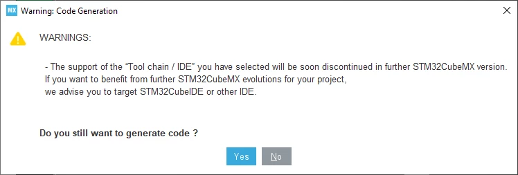

It's not a rumour, it's what I understood from this screenshot that obviously I read it the wrong way... :D

So, I understand that cubeMx stand alone is not end of life. Only support of trueStudio.

The message says support for your IDE (TrueSTUDIO) will be discontinued. It makes no mention of CubeMX being deprecated. The message is quite clear.
This makes sense as TrueSTUDIO has been NRND status for quite some time.
I don't see any indication that CubeMX will be open sourced.
