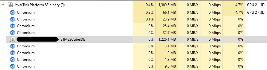

I decided to install the new versions CubeIDE (1.16.1) and CubeMX (6.12.1). OK, I worked with IDE and everything was fine even with old project. Then I needed to change some settings and pins. I opened CubeMX and migrate my old .ioc there started some strange things:
- CubeMX is loading my system (come one... look at my PC properties)
- didn't generated code but saved parameters to .ioc
Note: I tried to continue with old version CubeMX but it worked until the CubeMX started to freezing. After I closed .ioc and when I open it again - see the picture (white picture)

Windows 10 enterprise... provided by your work/school? If so, there may be installed some worthless сrар  intrusive "security" or "compliance" software. Try to convince your IT to remove it.

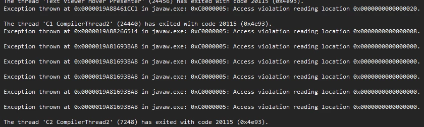

When I try to debug
I am getting this exceptions
It can be show something about the problem what you wrote to me.

It is possible to dig and debug, but someone should do this, right? If your IT allows, reformat the PC, reinstall clean Windows and everything should work.
Avoid unsupported or 3rd party applications, use standard and supported stuff. For example: Chromium is bad (do you know why it is installed?) Official Google Chrome is good. Edge is good.
