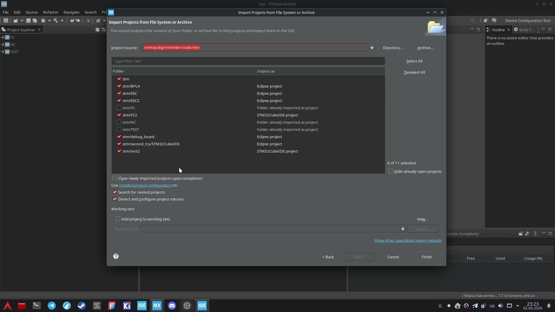

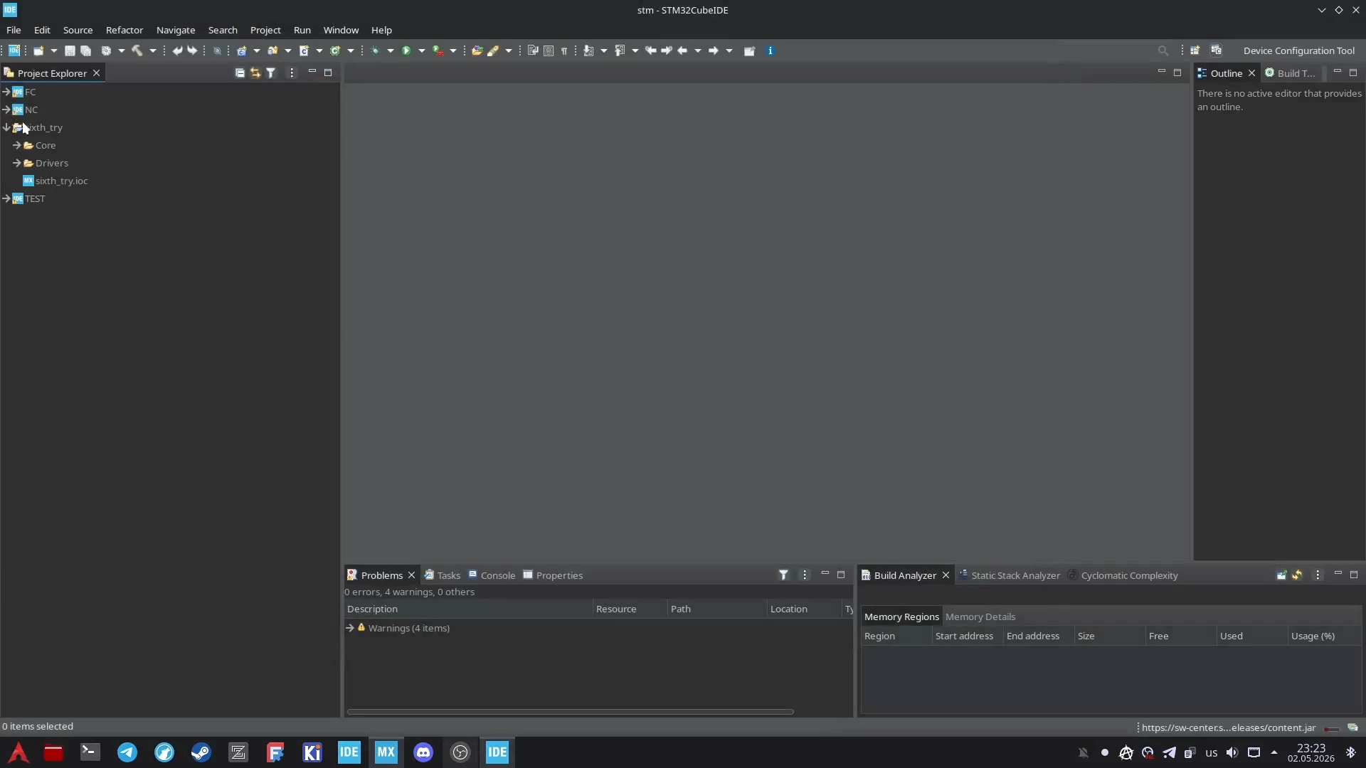

CubeMX don't generate rightly for cube IDE. Linux.
I tried multiple times to generate code on Arch Linux with CubeMX version 6.17.0 and Import in CubeIDE version 2.1.1. I made a video with process. And I don't know why this not working. I tried last and previos version of packages for STM32F0. And I don't know but CubeMX copied files very very slow.
I choosed CubeIDE toolchain in CubeMX.

Hello @MrKimler
Let's try to generate the STM32 project into a simple local directory on your Linux filesystem such as /home/<user>/STM32/sixth_try, and avoid using shared, synced, mounted, sandboxed, or unusual paths because they can cause very slow file copying and refresh issues.
Then import it into STM32CubeIDE using the correct project import method, preferably File → Open Projects from File System or File → Import → Existing Projects into Workspace, pointing to the folder that contains the generated CubeIDE project files like .project, .cproject, .mxproject, and the .ioc file; after import, do a Refresh, then Clean, and rebuild the project.
THX
