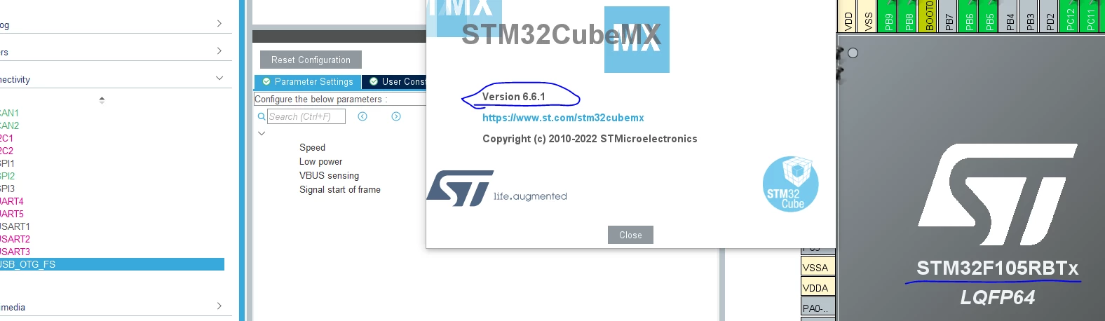

CubeMX doesnt generate MX_USB_DEVICE_Init function when FreeRTOS+USB CDC (Device) are selected together
0693W00000QNJXEQA5.pngI am using recently updated CUBEMX version 6.6.1
As soon as i enable FreeRTOS cmss_v2 in cubeMX the USB init disappears...
 MX_USB_DEVICE_Init is nowhere to be found........

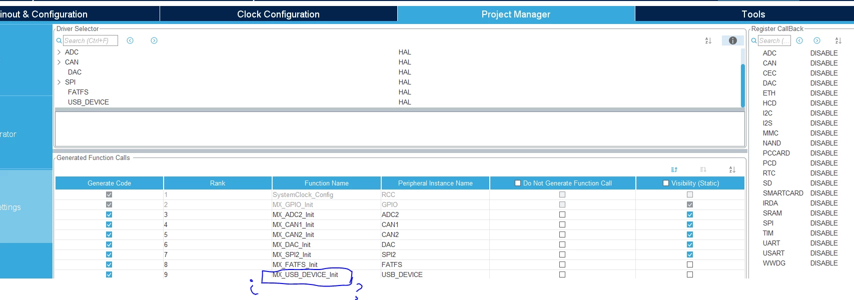

there is not USB_DEVICE folder generated in my project
I realiced the USB files are located directly under src/ directory now.
The directories where cubeMX puts the usb files have changed?
MX_USB_DEVICE_Init needs to be put manually in main.c .
/* USER CODE BEGIN 2 */
 MX_USB_DEVICE_Init();
 /* USER CODE END 2 */

No clue of what is going on yet....
this guy pulls it out without problem https://www.youtube.com/watch?v=QZaC2Qf5bJI and i believe we do the same steps.
i tried with CMSIS v1 ... same issue

tried the same thing with cubeMX 6.3.0, same issue.
