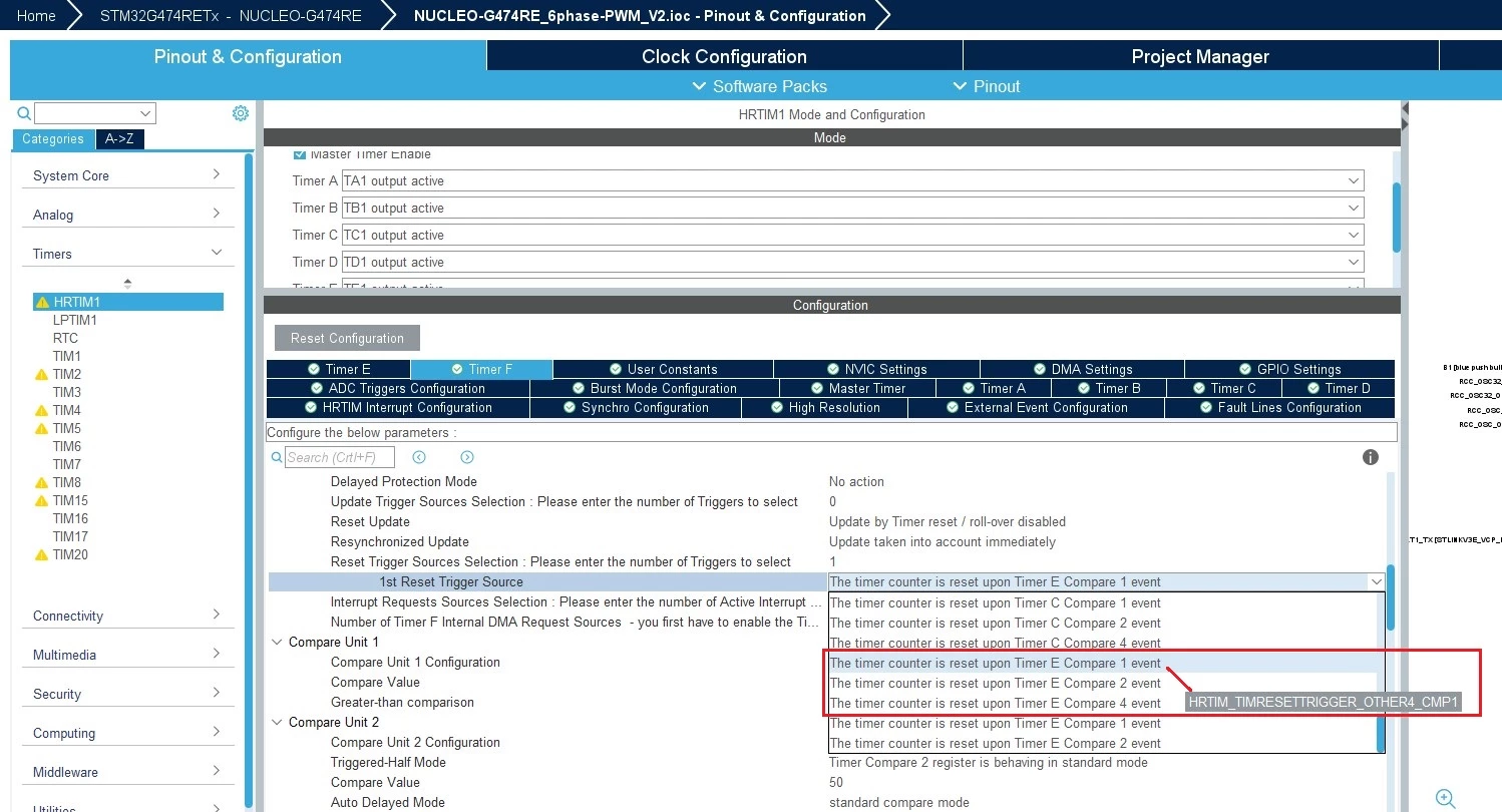

CubeMX does not produce the code for the reset source for HRTIMF1
  • May 12, 2021
  • 1641 views
I have here the setup of CubeMX

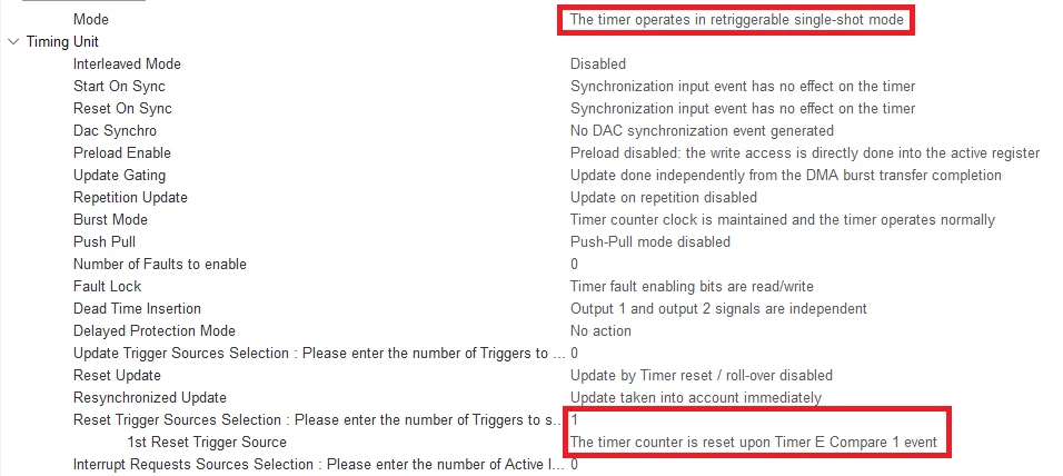

when I compile, the HRTIMF1 does not reset from HRTIME1 CMP1.
So I add manually the code
pTimerCfg.ResetTrigger = HRTIM_TIMRESETTRIGGER_OTHER5_CMP1;
Attached is the ioc file.

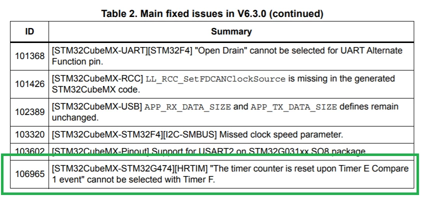

Best answer by Khouloud OTHMAN
Hi @victagayun​ ,
Good news :smiling_face_with_smiling_eyes: I am pleased to inform you that this issue is fixed in the latest STM32CubeMX version 6.3.0.
0693W00000D1W8pQAF.pngThanks for your contribution.
Khouloud.

Khouloud OTHMAN
May 12, 2021
Hello @victagayun​ ,
First let me thank you for feedback and for having reported. Issue reproduced and I assume that this problem is due to "1st Reset Trigger Source" list available through STM32CubeMX:
In fact, opening your attached .ioc and focusing on HRTIM1 Configuration panel > Timer F window tab > Reset Trigger Sources Selection > 1st Reset Trigger Source, the list of events that can be selected to trigger the reset of the timer counter seems to be faulty ( The timer counter is reset upon Timer E Compare 1 /2 event is mentioned twice ).
The selected trigger in your case is the first "timer counter is reset upon Timer E Compare 1 event" which is HRTIM_TIMRESETTRIGGER_OTHER4_CMP1.
With this being said, the issue is reported internally to be fixed as soon as possible.
Khouloud.
Khouloud OTHMAN
Khouloud OTHMANBest answer
August 4, 2021
Hi @victagayun​ ,
Khouloud.
