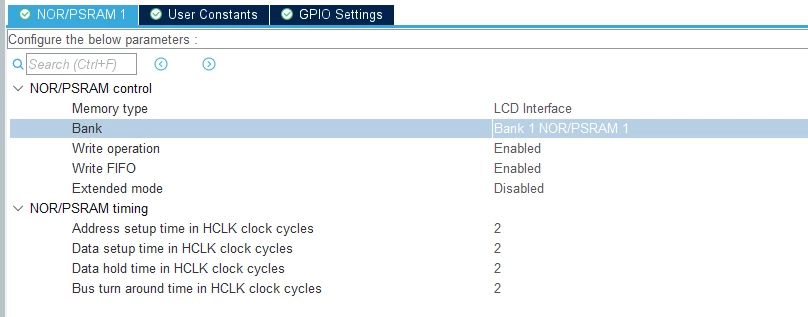

I probably found a bug in STM32CubeMX
CubeIDE = v2.1.1
CubeMX = v6.17.0
While configuring FMC like this.
This code is generated. The Timing.AddressHoldTime is set to 15 instead of 2 as configured in CubeMX

/* Timing */
Timing.AddressSetupTime = 2;
Timing.AddressHoldTime = 15;
Timing.DataSetupTime = 2;
Timing.BusTurnAroundDuration = 2;
Timing.CLKDivision = 16;
Timing.DataLatency = 17;
Timing.AccessMode = FMC_ACCESS_MODE_A;
/* ExtTiming */
if (HAL_SRAM_Init(&hsram1, &Timing, NULL) != HAL_OK)
Error_Handler( );
/* USER CODE BEGIN FMC_Init 2 */
/* USER CODE END FMC_Init 2 */
Please fix that

Hello ​@mraehle
Let me thank you for your feedback.
For more investigation, could you please provide your Ioc.File.
I will be waiting for your feedback.
Thanks.
