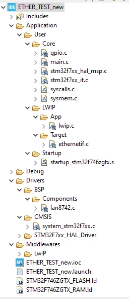

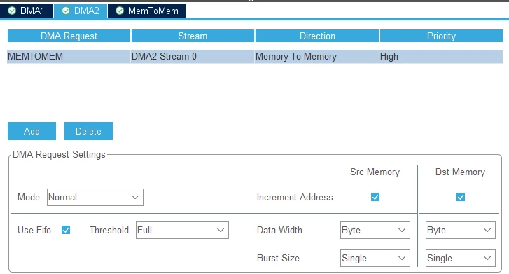

I'm probably doing wrong as a newbie in STM32 programmation:
I try to generate this configuration code for dma but I can't see any dma.c file in the project folder.
(I did refresh the project after generating the code)
Thanks for help

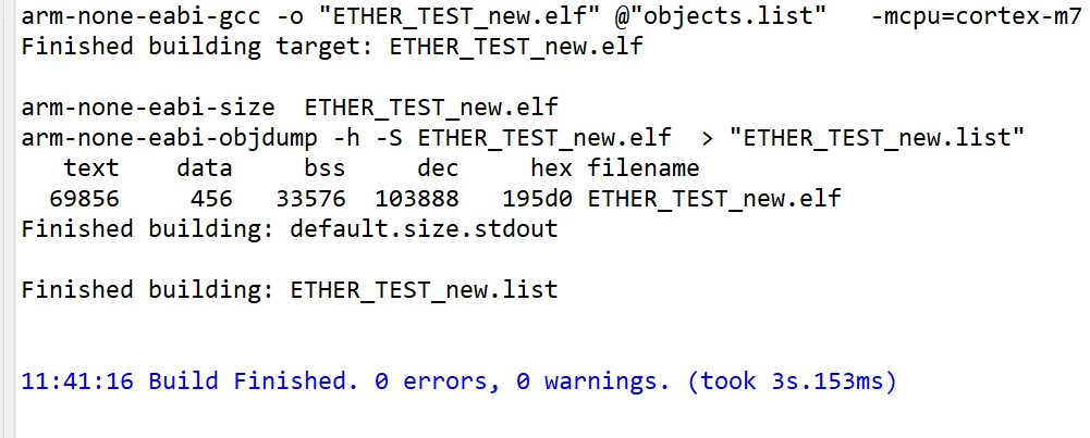

The project needs to be added to the workspace correctly.
First, remove it from the workspace. Then, either:
  • After clicking Generate Code, press the "Open Project" button
  • or, Open the .project file from the filesystem.
If you do that, it will build successfully:

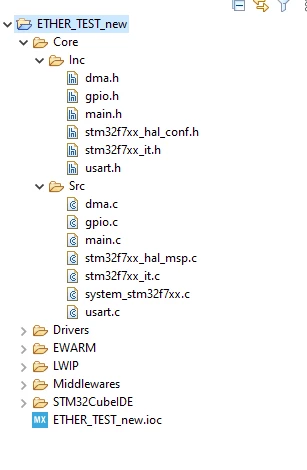

Hi there,
Maybe a part of my issue: the project was not save in the CubeIDE workspace.
Now that I copied it in the workspace I can see the right files tree:
But I get a new problem: I can't build the project neither save it. Some Icons are not actives in the Toolbar.
What I Am doing wrong?
Thanks for help

Hello @Segal ,
As mentioned @TDK, the project was generated correctly and the compilation completed without any errors.
I recommend that you delete the project under the workspace and regenerate the code.
Thanks.
