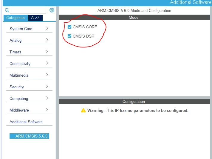

CubeMX CMSIS-DSP Include problems
I am including the CMSIS-DSP library on my CubeMX project on Additional Software. Using the Library setting instead of Source. However, when I am trying to call a function from arm_math.h the compiler throws an error that it is not possible to find that function call.
Any ideas? How can I include CMSIS-DSP.
I am using GCC compiler and STMCubeIDE

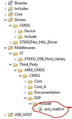

I had the same issue with CubeMX 5.5.5, one has to check on this screen the CMSIS packages:0690X00000Bwda8QAB.png
Then arm_math.h will appear:

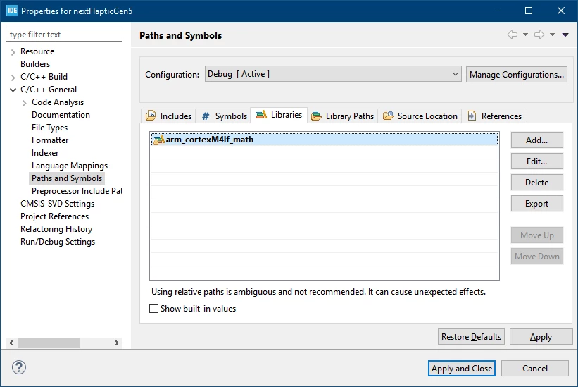

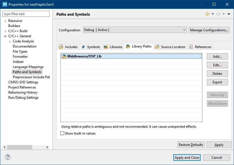

You can compile then, but the linker will miss the libraries. Lost a lot of time and figured out, that it worked for me as follows:
Copy both arm_cortexM4lf_math.lib and libarm_cortexM4lf_math.a to a manually created subfolder:
Set the Path for libraries then:
And specify the library to be used - without extension!!!!:
Don't know, why I have to copy both arm_cortexM4lf_math.lib and libarm_cortexM4lf_math.a, took a long time to figure out, which type of libray is the right (I have a STM32F4 - it looks like it's little endian, with FPU). Don't know why I have to specify the library name without an extions. But it seems to work now.

oe3arc
Jan 30, 2020 3:39 AM UTC
Correction:
It is sufficient to copy only libarm_cortexM4lf_math.a.
Without extension and without the prefix 'lib', i.e. the file namend libarm_cortexM4lf_math.a has to be specified as libarm_cortexM4lf_math.a in the Path and Symbols dialog.
hth
Andy

OSala.1
OSala.1Author
Jan 30, 2020 10:58 AM UTC
Thanks Andy! That worked well for me.
In older versions I had to manually add CMSIS DSP just like you stated, I thought that in this new CubeMX version they managed to do the work for the user...
