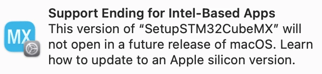

Are there plans to update CubeMX to support MacOS 27 and later? I have just installed 6.17.0 under MacOS 26 and I get a warning to say the installer will not work with later versions:
This is because support for the Intel translation layer will be removed (M series Macs are now into their 5th year).
Note the CubeMX app itself does not get this - just the installer.

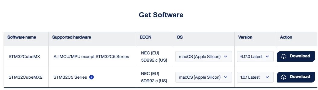

As you see, both CubeMX and CubeMX2 have versions for Apple Silicon (aka AARCH64).
Is this what you're using?

Thanks - I was updating an Intel Mac and installing on an M5 at the same time, and it looks as if I downloaded the wrong file.

Just downloaded STM32CubeMX for macOS (Apple Silicon) (SetupSTM32CubeMX-6.17.0-Mac-ARM.app.tar.gz) and got the same notice. MacBook M5 Pro. However seems that program installed correctly. (I am starting my journey with STM32)
