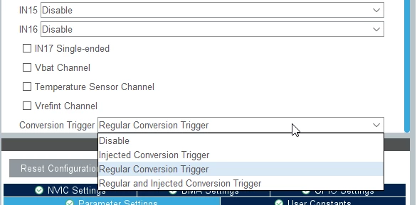

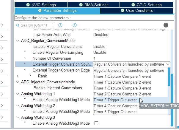

CubeMX 6.7.0 for STM32U575Z ADC1 does not allow external trigger to be "ADC1_EXTI11"
  • January 24, 2023
  • 1 reply
  • 1482 views
It seems, as if CubeMX6.7.0 for STM32U575Z_Q for ADC1 external trigger you cannot choose ADC1_EXT_IT11
or ADC1_EXT_IT15
Is my observation correct? Is this missing?
Best answer by Johannes
Sorry. Found my mistake. It needs to be enabled first with this processor
