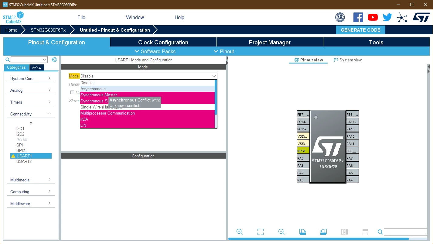

I would like to report 2 bugs.
  1. I created a blank new project for STM32G030F6P6. When I try to enable USART1, it says "Unknown conflict". See the attached screenshot.

Amel NASRI
May 13, 2022
Hi @a.gajdacs​ ,
These are 2 possible limitations. Unfortunately your post wasn't reviewed on time because it was missing relevant topics.
I let our STM32CubeMX expert @Sara BEN HADJ YAHYA​ analyze what you reported and take relevant actions.

a.gajdacs
a.gajdacsAuthor
May 22, 2022
Hi Sara,
Sorry for the late reply.
The issue No. 1 seems to be resolved now, it must have been a transient flaw.
